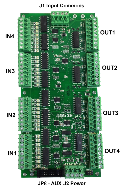

J2 Konnect Power
The power signals from KFLOP's Aux Bus are available on the J2 terminals. It is not normally necessary to apply power to these terminals as power is supplied from KFLOP through the JP8 connector. For multiple boards it may be desirable to apply additional higher gauge power and GND connections between boards. Note the Signal labeled 12V is connected to the KFLOP 12V signal but may not be necessarily 12V. KFLOP and Konnect do not require or use the 12V signal but only pass the signal through the various connectors. Disk Drive Power Supplies usually supply +12V into KFLOP JR1 Pin 1. Also note that if any of these supply voltages are used for the Inputs or outputs then the Input wiring will not be isolated from KFLOP.
It is possible to supply +5V power to KFLOP through these terminals if the power consumption on KFLOP is less than 1 Amp and the ribbon cable connection is short (several inches or less).

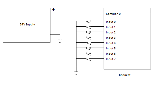

Konnect's 32 optically isolated inputs are grouped into 4 independent Banks of 8 inputs. This allows any Bank to be used with either sourcing or sinking signals. However all inputs in the same bank share the same common and must operate in the same mode. The 4 independent Banks also allow different supply voltages and supply isolation to be used for each Bank. 24V is the preferred input voltage and will draw (24V - 1.4 - 1.4)/4K ~ 5ma of current.
Konnect's 32 optically isolated inputs can be driven from a +/- 4.75V to a +/-25V signal. Less than 2V should be applied to ensure the input is off. One of the 32 input circuits is shown below. The input consists of a AC type of Optocoupler in series with an LED indicator in series with a 4Kohm resistor. The AC type of input allows the common to be connected to either the Positive or Negative Supply voltage so that either sinking or sourcing outputs can be used (current can flow either direction to activate the input).
External Wiring would typically be arranged such as:

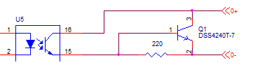

Each of the 16 Optically Isolated Outputs is completely isolated with a + and - terminal. When active the output passes current from the + to - terminals much like a relay contact would.
The Outputs are capable of driving medium power devices such as relay coils. Loads up to 30V @ 250ma may be driven.
The internal Konnect Output Circuitry is shown below which converts a photo transistor output to darlington transistor output. The 220Ohm resistor allows the output have a low on voltage for low currents before the transistor turns on. This allows the output to drive low current circuits with a smaller on voltage(2ma @ < 0.6V). For example LVTTL/TTL inputs require less than 0.8V to guarantee a low input. At higher currents Q1 becomes active and keeps the on voltage drop below 0.9V at 0.25A. Switching 0.25A at 24V allows loads up to 6W to be driven.

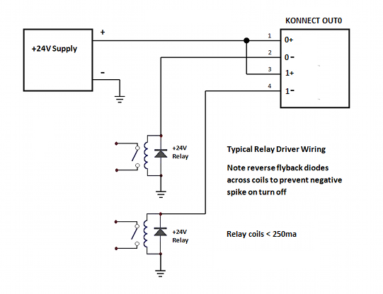

A typical wiring diagram driving 24V relays. Because of the less than 0.9V drop on the Konnect outputs the load will be driven with more than 23.1V.
Board Address Selection Jumpers
The KFLOP's Auxiliary Port works as a Bus where multiple boards can be connected to the same Port. Each board has an address so it can be selected as active. For a single Konnect board in the system removing all Jumpers will configure the Konnect Board Address as zero. If multiple boards are to be used set each board to an unique address.
