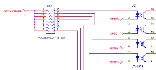

The input circuit for 4 of the 16 opto inputs is shown below. Note there is a common Anode for all 16 opto inputs which is normally tied to a +12 or +24V supply. Each of the negative opto pins are then switched to ground (return for the +12 or +24V supply)

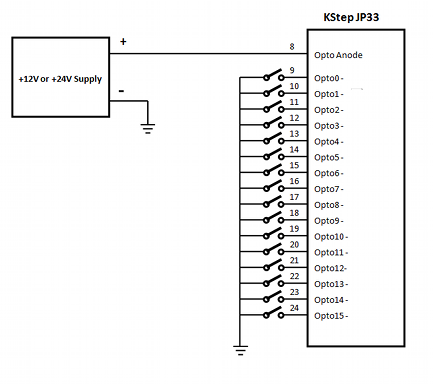

External Wiring would typically be arranged such as:

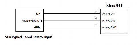

Optically isolated PWM to Analog Circuit
A 3.3V PWM output from KFLOP IO 44 JP7 pin 5 is normally connected to KStep JP36 Pin 5 to drive the PWM to Analog circuitry. Often a VFD will have 3 input terminals where a potentiometer can be connected as speed control. The three connections AnalogVcc, AnalogOut, and AnalogGnd can be connected to perform a similar function as a potentiometer. The AnalogOut voltage will vary from AnalogGnd to AnalogVcc voltage as a function of the PWM duty cycle.

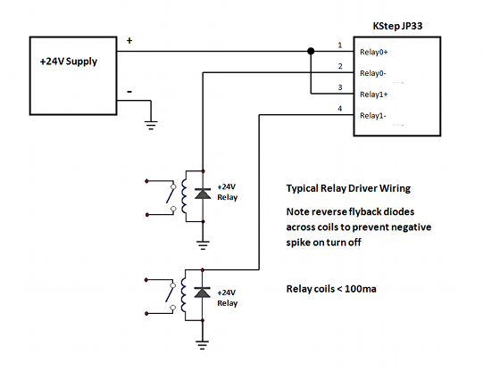

Two Optically Isolated Outputs are provided to drive medium power devices such as relay coils. Loads up to 30V @100ma may be driven.
The internal KStep circuitry is shown below which converts the incoming 3.3V LVTTL inputs to darlington transistor outputs.
A typical wiring diagram driving 24V relays.

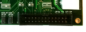

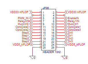

JP36 To KFLOP
JP36 is designed to connect directly to KFLOP's JP7 in a 1:1 connection. KFLOP is then able to supply the 4 sets of Step/Dir signals, the Enable, the Analog PWM signal, the 2 Relay Driver outputs, and connections for the 16 opto inputs, as well as +5V (used if running without opto isolation). To conserved KFLOP IO pins the 16 opto inputs are read back in a multiplexed fashion 4 bits at a time where 2 outputs from KFLOP select which bank of 4 are currently selected. +3.3V is also provided to power the opto multiplexing circuitry.
