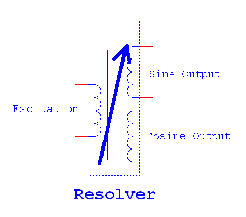

Shown below is a schematic symbol of a Resolver. The arrow indicates a varying coupling between the excitation input and the output coils as a function of rotor angle.

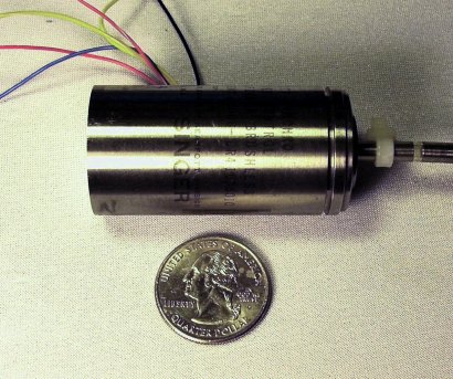

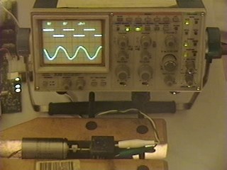

Here is a typical resolver unit (manufactured by Singer) with 6 wires, two for each of the three coils. The wiring of a resolver can usually be determined using a simple ohmmeter. The ohm meter can be used to determine which pair of wires belong to a coil. Furthermore the sine and cosine coils should have a very similar resistance and usually different from the excitation coil. In the resolver shown below the excitation coil has a resistance of 20 ohms and the sine/cosine oils have a resistance of 37 ohms. Swapping the sine and cosine coils will simply reverse the measured motion.

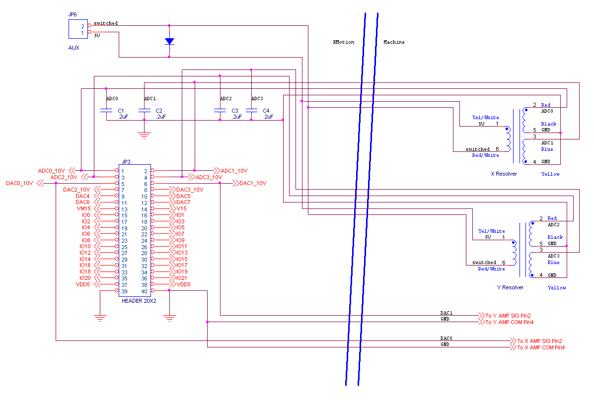

The example layout below shows the connections for a single resolver. Because KMotion has only 4 ADC inputs, KMotion is limited to interfacing to two resolvers. If more axes are required then digital encoders must be used. For testing purposes a small DC torque motor is shown connected to the resolver. The DC motor is driven from one PWM output using the +12V supply. A more likely scenario for an actual CNC retrofit would be to use the existing motor power amplifiers driven by KMotion's +/-10V DAC outputs.
A wiring diagram for a complete 2 axis resolver is shown below. Also shown is the DAC output connections for connecting to external power amplifiers with +/-10 V Inputs.

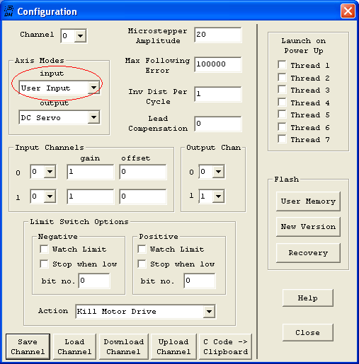

The Configuration Screen input mode is shown here set to "User Input". This allows the User Program shown above to be in charge of setting the current position.

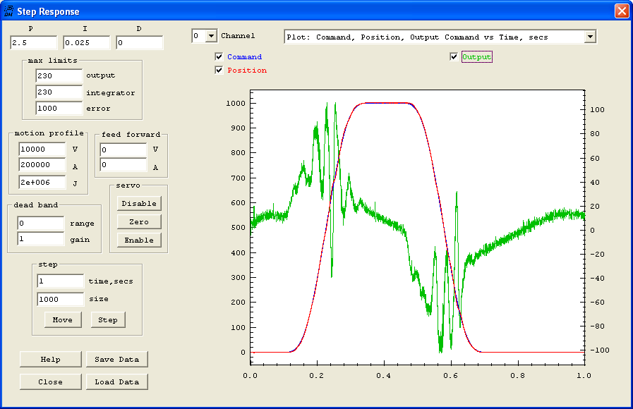

Here is a Move Plot of a move of 1000 which corresponds to 1 shaft revolution of the encoder. Not the Command (Blue) and Measured (Red) positions are nearly overlaid.

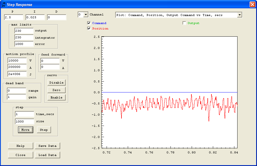

Zooming in on the position gives an indication of the position resolution and noise level. The signal shown below has a range of approximately +/- 0.5 counts where 1 count is 1/1000 of a shaft resolution. So for example on a system with a 5 pitch lead screw (0.200 inches / rev) this would correspond to +/- 0.1 mils (~ 2.5um).
