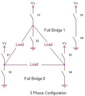

KMotion also has a 3 Phase mode where two full bridges (only 1/2 of the second is used) and two PWM timers work in a special configuration in order to drive a 3 phase brushless motor. See the circuit configuration below. Here the supply voltage may be effectively applied at any phase angle (direction toward any of the 3 loads). The method utilized is analogous to the Normal mode described above and has smooth transitions through reversals.
