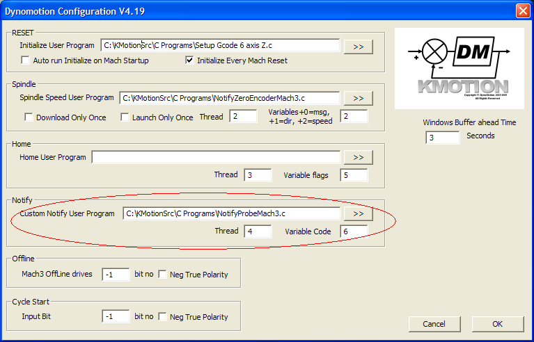

Required KMotion/KFLOP User Program
In order to perform Probing, the the Notify User Program must be configured to properly handle message 20000 and selected in the Mach3 Plugin configuration.
Add the message handler shown below to the Notify program for your system. During probing the DynoMotion Plugin sends a Notification 20000 message to the configured KMotion/KFlop Notify User Program.
