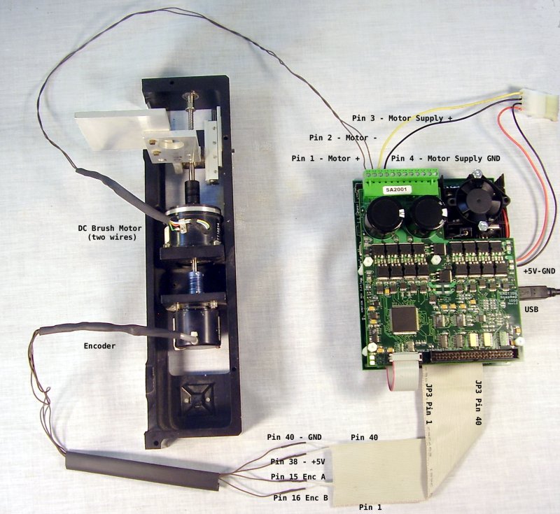

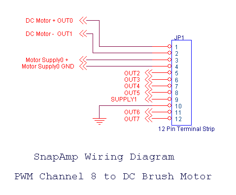

Wiring the Motor, encoder, and Power

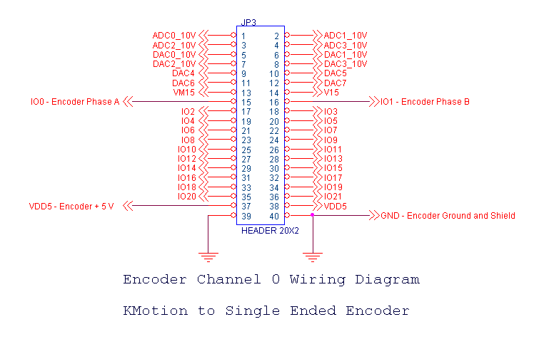

This example configuration shows a single dc brush motor connected to the first of 4 available full bridge drivers on a single SnapAmp 1000. A single-ended encoder is connected to KMotion's JP3 connector as encoder input #0 for Servo feedback. (The KMotion board is hidden underneath the SnapAmp in the photo). Note: Encoders typically come as one of two types - differential outputs (having A+, A-, B+, B-) or single ended outputs (A B). A differential encoder may be used as a single ended encoder by only using the A+ and B+ signals (and leaving the A- and B- unconnected). However single ended signals are more susceptible to noise than differential signals. KMotion has 4 single ended encoder inputs. SnapAmp 1000 has 4 differential encoder inputs. In this example a KMotion single-ended encoder input is used. Some encoders have a index pulse that occurs once per revolution usually labeled as channel Z. In this example the index is not used and is not connected.

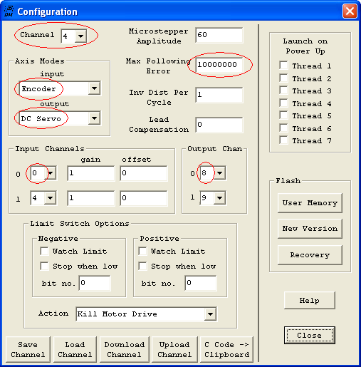

On the Configuration screen Axis Channel 4 is selected, the input type is set to Encoder at encoder channel 0, the output type is set to DC Servo at PWM channel 8, and a very large following error is set.

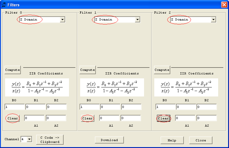

On the Filters Screen all filters are disabled by "Clearing" all filters to have a gain of 1.

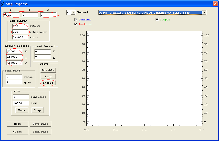

The Step Screen servo loop (PID) parameters are set to only very low proportional gain. The max output is set to a small value that should still allow some motor motion. SnapAmp DC Servo mode outputs current commands in the range of -1000 to +1000 which corresponds to approximately -30Amps to +30 Amps. So a max output of 100 will limit the current to 3 Amps. Although the Integrator will not be initially used we set the max integrator to also be 100. The max error is set to a large number. The motion profile parameters are set to values that we will expect to eventually achieve. Our example uses a low speed torque motor being driven off of only 12V. This encoder has 4000 counts/rev so a speed of 50,000 cnts/sec corresponds to 12.5 rev/sec (750 RPM).

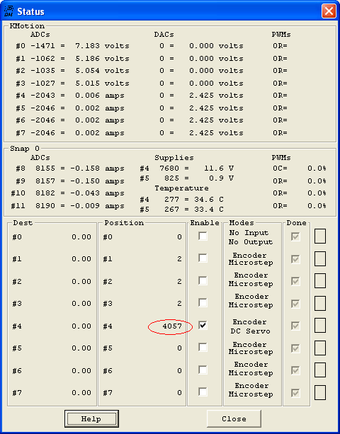

With the Motor Power Supply tuned off, pushing the Enable button will download the parameters from all screens and enable the axis without any motor motion. This will allow us to ensure the axis is properly wired and configured as encoder input and of the correct encoder channel.
We can now rotate the motor/encoder shaft by hand and should observe counts on Axis Channel 4 on the Analog Status Screen. Note if one of the other axis's configurations also is defined as input Encoder channel 0 then that axis may count as well. The default configuration for axis 0 is Encoder input from channel 0. To avoid confusion, disable any other axis by selecting that axis, define the input/output types as "No Input" and "No Output", then download, then disable the axis. To test the encoder, rotate the encoder and check if the expected number of counts per rev are obtained. Rotating the axis the opposite direction should count in the opposite direction.

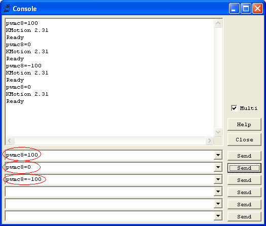

In order to test the Motor Amplifier functionality Console commands (PWMC - Pulse-Width-Modulation Current Mode) will be entered to drive the motor in the forward and reverse direction. The axis should and must be disabled to issue these commands, otherwise they will be immediately overwritten with servo output commands. Small values should be used initially. Note: PWMC commands may only be used with a SnapAmp (Software Version 2.31 or later), the KMotion onboard amplifiers do not have current feedback mode so PWM commands should be used instead. SnapAmps's PWMC current commands range from -1000 to +1000 which corresponds to approximately -30Amps to +30 Amps. So a value such as 100 might be used to provide a drive of 3 Amps.

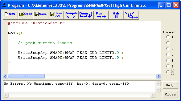

Before issuing the PWMC commands, SnapAmp's peak current fault levels should be set. After verifying that the axis is disabled (on the Analog Status Screen), load and execute the following program to set the peak current limits. The Fault Green LED on the SnapAmp should turn off. The "I'm alive" Green LED should remain blinking.
Setup the Console Screen as shown below. Sending the commands should drive the motor in one direction, then no motor drive, then drive in the other direction respectively.
If the motor and encoder are working we are ready to attempt to close the servo feedback loop. All that is required is to enable the axis by pressing "Enable" on the Step response Screen. Normally one of two things will occur. Either the axis will respond as a weak servo, or the servo will have positive instead of negative feedback and runaway from the target destination rather than toward the target destination.

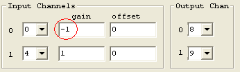

If the servo has positive instead of negative feedback, something should be reversed. Either the Motor leads may be reversed, the encoder signals may be reversed, or a Input Gain of -1 may be entered on the Configuration Screen (as shown below).

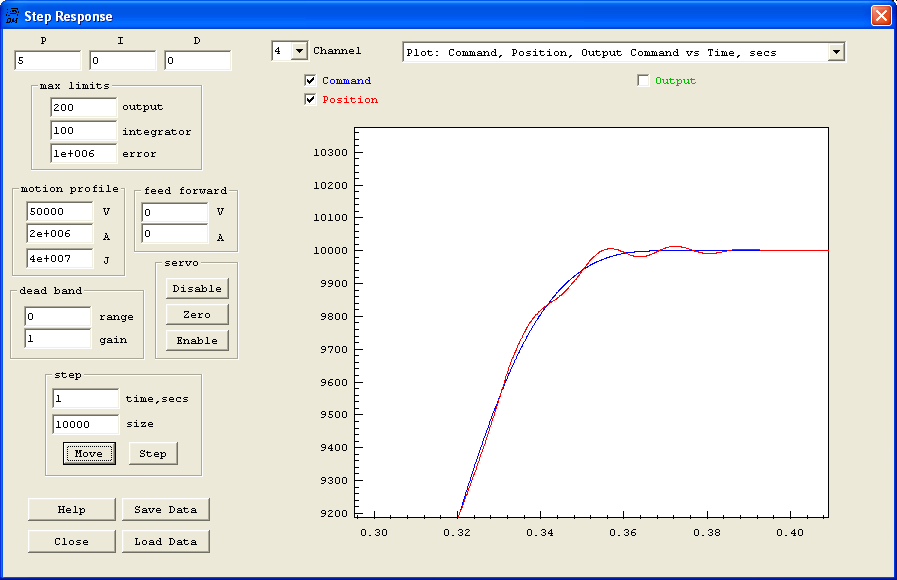

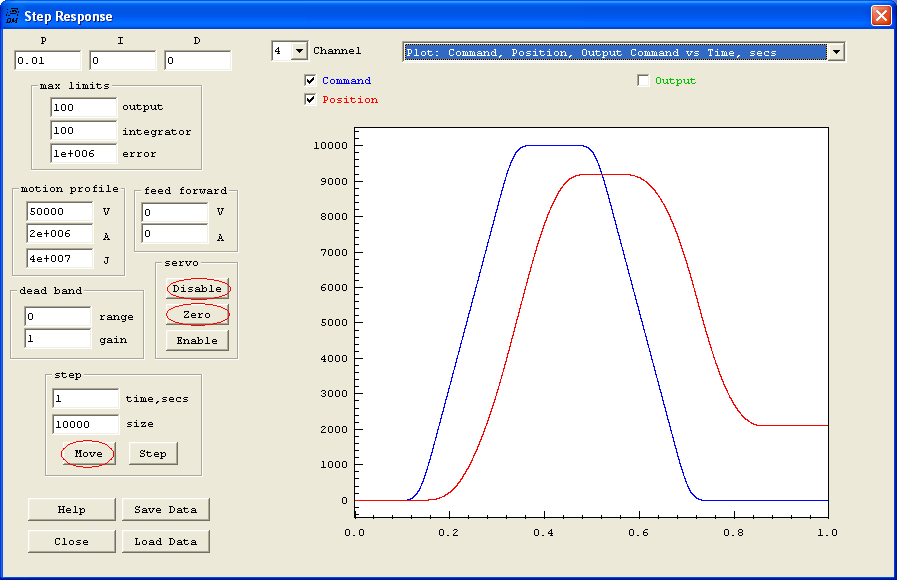

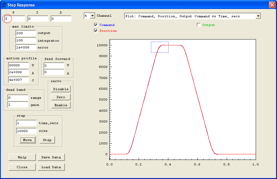

To test the current performance, disable the axis, manually move it to a position where it may move +10000 counts, then push the "Move" button. A plot such as that shown below should be observed. Set the plot type and axis selections to agree with those shown below. The blue plot is the desired path as defined by the motion profile and the motion is made for 10,000 counts and then a second motion is made back to zero. The red plot is the measured encoder position. Note that the red plot attempts to follow the blue plot but with a large error of thousands of counts. Gradually increase the P gain (possibly by factors of 2) while pushing the Move button and the following error should reduce. At some point the system will probably go into oscillation and become unstable. It may be necessary to disable the axis, reduce the gain, and re-enable the axis.
Increasing the gain 500X (from 0.01 to 5) results in a much better response. Notice the blue (desired) plot is almost completely hidden behind the red measured plot. However by zooming in to the purple rectangle (left click mouse drag) we can see oscillation. See the second plot below.
Increasing the derivative gain can often reduce oscillation. In the plot below we have set the D gain to 16. Notice the oscillation has been reduced.

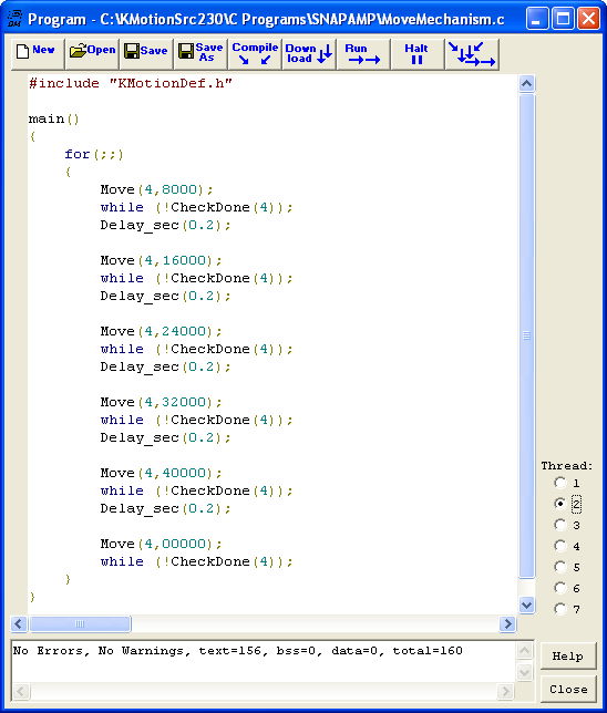

The C program below is an example of a simple program to perform a sequence of moves and repeat. There are 5 moves of 8000 counts (2 motor revs) and then a move back to the start. After each small move there is a wait until the motion is complete followed by a 0.2 second delay. Here is a video of the mechanism executing the motion.
