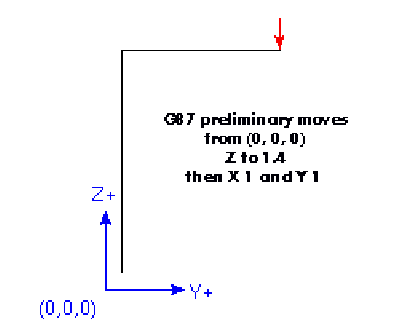

Example 6 - Backbore
Example six uses a incremental distances from (0, 0, 0) so the preliminary moves look much like those in example five but they are done using the G87 backbore canned cycle.
G91 G87 M3 S1000 X1 Y1 Z-0.4 R1.4 I-0.1 J-0.1 K-0.1
You will notice that the preliminary moves shift the tool to directly
above the center axis of the existing bore.
