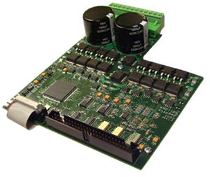

SnapAmp is a Multi-purpose Multi-Axis Amplifier board for KFLOP
