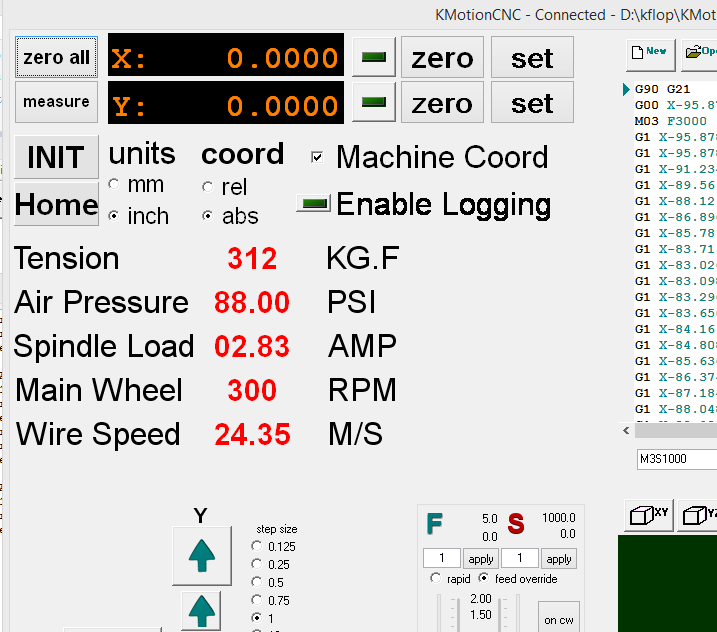

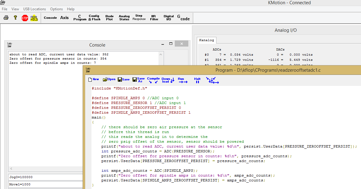

I think things are working OK, I do however have to apply a 'zero offset' correction factor. For the VFD analog out I'm seeing around 7 ADC counts at zero output, which Kmotion reports as 0.034 volts. If I measure this with a DMM I get 0.012 volts, same reading whether Kflop/Kanalog are powered or not (measured at the Kanalog terminals). So what I''m doing to correct for this offset is run a 'find offsets' routine once, that stores the offsets in persist vars, then when I read in the values in the forever loop I subtract the zero offset counts stored in the persist vars.
Does this seem like a logical approach or is this a 'fix' for a possible hardware problem? Other than that the updating of the DROLabels is working great. I have 3 inputs, the VFD analog out configured to output the vfd output amps, a pressure sensor, and a Magnetic proximity sensor connected to an opto in that I'm using as a tach counter (low rpm). I used the Debounce routine found in the C programs dir, although I did have to turn down the #define DBTIME 300 to 30 (higher may have worked, that was my first try) to catch the changes. What unit is the DBTIME in?

A few counts of offset would be normal. Kanalog is designed to be precise but not necessarily accurate as 1% resistors are used. Once calibrated to correct for resistance values I wouldn't expect much change.
