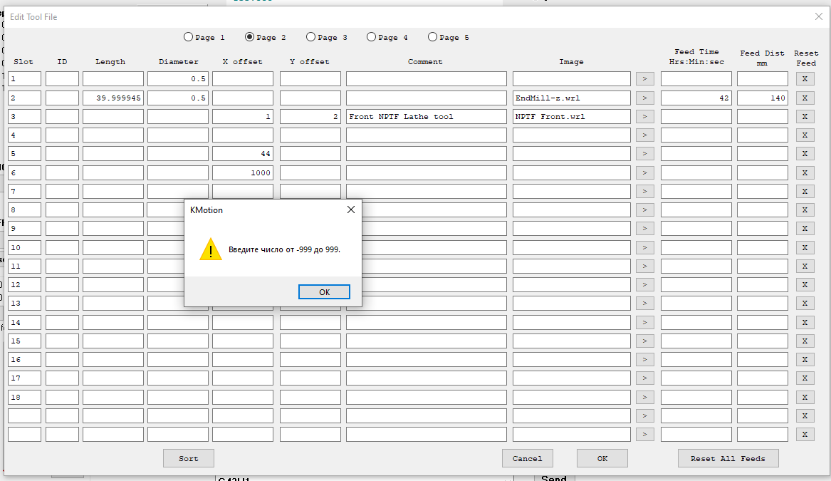

Hi Tom.
Where can you increase the range of numbers entered into the table of instruments ?
It is currently limited to 999.
Taras.
Posts: 2951
Re: On hower
Post by TomKerekes » Sat Mar 09, 2024 5:19 pm
Hi Taras,
These lines and similar in EditToolFile.cpp
	DDX_Text_Blank(pDX, IDC_Length0, m_Length0);
	DDV_MinMaxDouble_Blank(pDX, m_Length0, -999,999);
