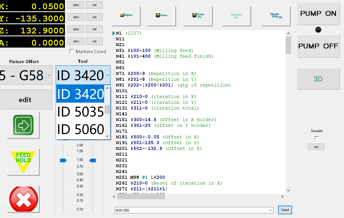

I made a screenset for my machine which has a touch screen (basically a 10" tablett with windows), it is working very well, but the size of the scroll bar is small for an easy usage (Tool list & Fixture selection), is there a way to increase it?
Cordially
Francois
Size of scroll bar
- Posts: 2948
Re: Size of scroll bar
Not with the Screen Editor as it is controlled by Windows. You should be able to do it globally as described here:
Thank you Tom, it works perfectly, the more I use KmotionCNC the more I love it (especially compared to mach3).
