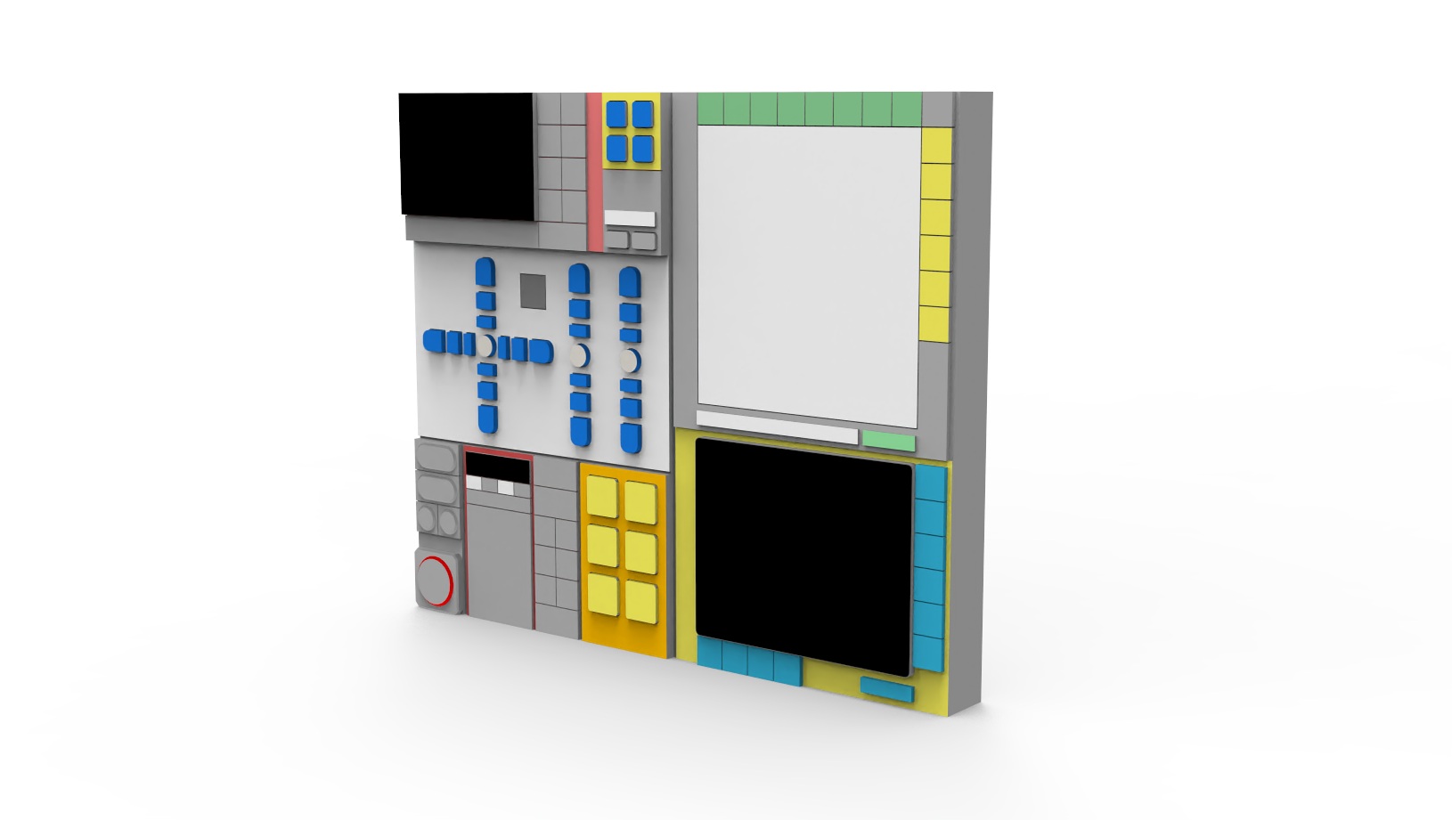

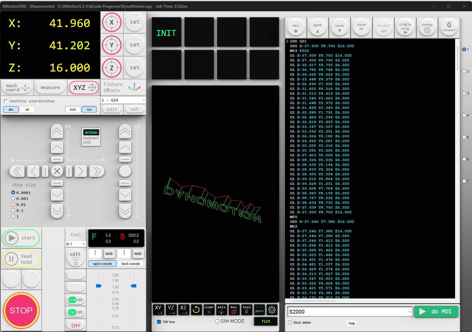

Hoping to get some feedback on a custom screen I created for KmotionCNC. I started this as a way to see if I could make a dark mode/screen, as well as improve the overall look and clarity of the software. This was an earlier dark mode background that i was working with:
I think it would be sweet to develop that concept further, the main roadblock I ran into was completing the dark mode look for things like checkboxes, radio button, scrollbars etc. I was able to create a custom lexer for dark mode coloring and recomplile the scintilla editor (and KmotionCNC). Also made changes to the source for the gviewer to better fit a dark look.
I made a big effort to be able to "skin" or assign images to checkboxes/radio buttons, mainly by attempting to convert them to buttons/autoradiobuttons etc but I was not successful. Mainly I was trying to create "chrome style" tabs instead of radio buttons for selecting which gcode file is selected in the editor. And toggle(image)button functionality for things like mm/inch selection. Im sure it is very possible, just still learning on my end :D Perhaps Tom could suggest a wise way to accomplish this. (finding it hard when the other code sections rely on radio/checkbox functionality, an issue with my skills for sure). creating new (dark) scrollbars for the editor is also far beyond my current ability. I also tried making KmotionCNC use windows dark mode in the manifest file but was unsuccessful.
regardless, I am fairly happy with the light grey version shown in the first pic, just wondering if I could get some community feedback on the general look and feel. The entire UI was created using a Solidworks 3D modelling process and then photo rendered with different materials/lighting etc. Icons were derived from these same renderings to give a realistic feel. Took some inspiration from DJ/music creation equipment :D
Definitely has been a fun, educating experience, working on updating to the latest kmotioncnc and posting something people can try out. As it stands, everything is working with 5.34, just not with a complete dark mode/screen. Some things will probably be broken with the latest Gviewer upgrades but who knows.

Hi Curtis.
Very impressive. I like it.
We may look into how difficult it would be to support.
Please post your changes. Do you think it would be difficult to use the Screen Script Dlg Control's Background color?
I like it. Much clearer than the default.
Any creative job openings at Dynomotion Tom? :lol:
Well... If you post all your changes we can offer a free board of your choice. Contact support with your address.

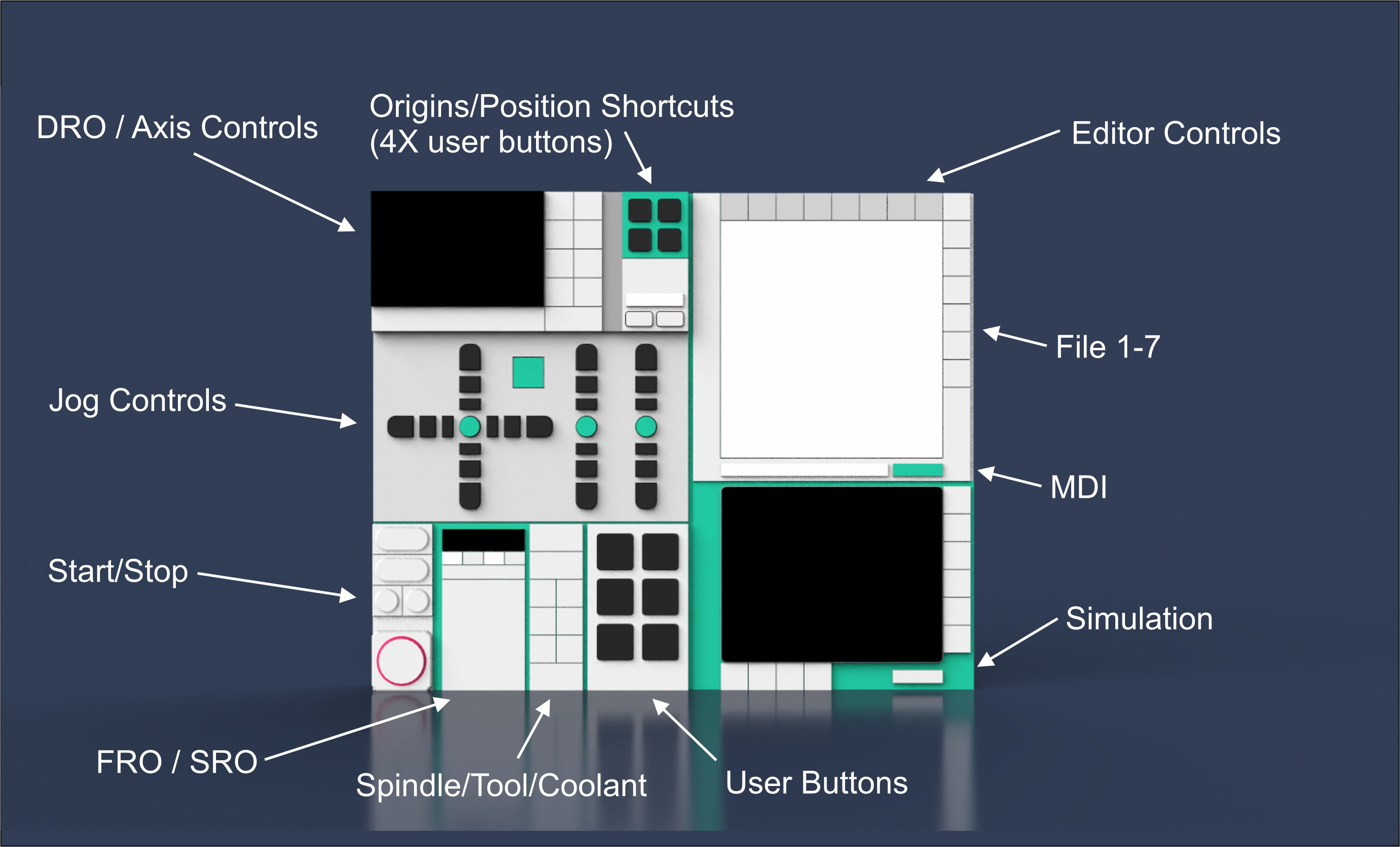

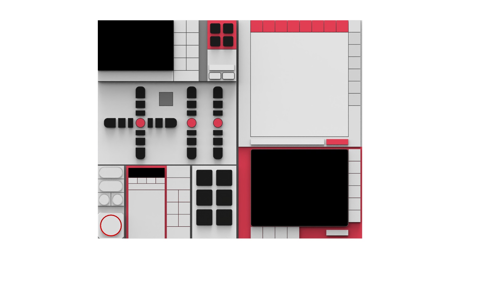

I am almost done the new layout, switched to a new resolution of approx 1000 *1200 so that the layout fits well on 1080 resolutions with room to spare on the screen for Kmotion Console, file explorer etc. Tried to take inspiration from real life CNC operator interfaces. I think I like the stacked editor and Sim, but they could easily go beside each other with a more "fullscreen" version (closer to 1920 wide)
This is what happens when engineering meets UI design :lol:
Let me know if you have any feedback, shouldn't take me long to update the icons and post the screen. (both 3 axis and 4 axis). Thinking of doing a couple color accent options, definitely need a Canada theme :D
