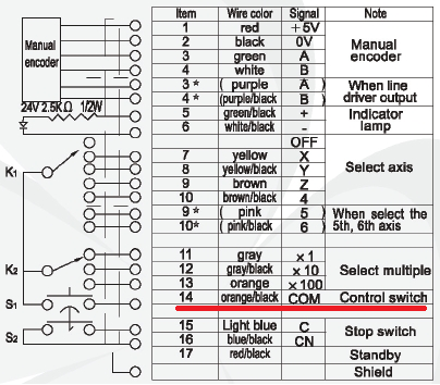

Hello everyone,
I am configuring the interface of KFLOP and an MPG controller (wiring scheme attached) and I would like to know if there is any example of C program where:
- when the Control switch is pressed the encoder control axis position.
- when the Control switch is released the encoder control FRO.
Guilherme
Guilherme
