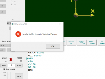

Hi Tom ,installed 4.35h and still have the same Gcode Error pop up when trying to run a Gcode. Attached Picture.
George

Hi Tom, got ride of the gcode error. Tried to run The attached RTCP code but came up with attached errors.

Gcode error came after buffer error.
George

Did you hit Halt when that occurred?
George Butty
- Posts: 111
- Joined: Sun Mar 22, 2020 9:36 pm
Re: 5 axis CNC Router/3d printer
Hi Tom, no I did not hit Halt. Just started RTCP code that I sent you and it went as far as the B45 line and then kicked out the buffer error
and after I cleared that error the Gcode error popped up.
George
George

I believe that is a bug. I was able to re-produce. Basically the Trajectory Planner was attempting to "Round" the corner on two Pure Angle moves (without any motion).
Here is a patch for Version 4.35h. Copy to the \KMotion\Release folder.
GCodeInterpreter.dll
Here are two source files that were changed in case you re-build the Libraries. Copy to the \GCodeInterpreter folder.
TrajectoryPlanner.cpp
TrajectoryPlanner.h
Please let us know if it fixes the issue or causes any problems.
