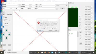

Hello. Thanks for the add. I use kmotion on my cnc. I only use three axis and would like to increase some of the sizes on the basic 3 access screen. I cant get the screen editor to sync sync the cnc software. I keep getting this error. I have two computers on my machine. One as a back up. I cant edit in either computer I get the same error....... :shock:

Post by TomKerekes » Thu Apr 09, 2020 10:37 pm
Hi Corianman,
What Version of Windows?
What Custom Screen Script did you load in KMotionCNC before running the Screen Editor?

I cleared the line for separating after selecting Custom like in your you tube video. I tried on three computers. All show the red X. No editor loads

I can't duplicate the error. Please try the following:
  1. Disconnect any KFLOP
  2. Fresh Install of KMotion 4.34
  3. Run KMotionCNC.exe
  4. Tool Setup | Set Dialog Face to Custom and blank Screen Script File name
  5. Run KMotionCNCScreenEditor.exe
Microsoft Windows displays a Red X when there is a call to an OpenGL Graphics Function that has an Error. The Red X can appear if OpenGL is not supported on the computer. But more likely is caused by something like an invalid/corrupted Screen Script file resulting in something invalid being attempted.
You might run GLView to test the OpenGL on your PC.
