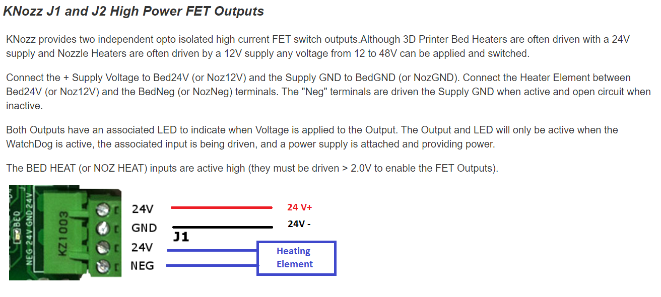

Just plugged in my KNozzle to test it out. As soon as I run "KNozzControlTemptsMCode.c" the watchdog signal kicks on, and the heater turns on. Checking the console, it says the nozzle and bed setpoints are 0C, and I dont have any thermistor hooked up. Does this seem right? The documentation is slightly confusing about where the power goes. Is my image here correct?

The setpoints would be the setpoints you set. Did you configure an MCode to use Var 30? What values did you set with the MCode P Q parameters?
The ADC reading should be 0 with out any resistance connected (open circuit). See
here.
I don't see any image.

I tried to add a picture a number of times last week, but it wouldnt attach. It shows in the bottom, but when I click the "preview" button the attachment is removed. I tried a JPG, TIF, and PNG file format.
No I didnt use an M-Code, the P and Q parameters are both Zero. That was why I was surprised that the coil started to heat.

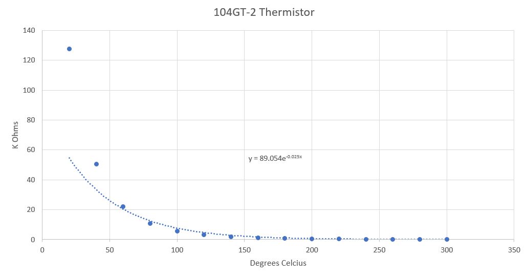

The 3D printer I am making needs to be able to handle temperatures close to 300 (475 F) degrees C. So I will need to use a different function to convert temp to ADC. Here is the one I am trying to use(part number 104GT-2) sold on Amazon, rated to 300 degrees C.
https://www.mouser.com/datasheet/2/362/ ... 202937.pdf
My plan was to plot the profile, and make an equation for the function. Here it is:
This is my first time trying to profile a thermistor and I am not certain I did it right. If I did, my concern is how flat the curve is at the upper range of temperature. At a fraction of a KOhm the temperature jumps a lot. Do you think this would make for stable control?
If you think it will work, my next step is to convert KOhms into ADC counts, and put the equation into the function?
Scott

Amit tried to use the same sensor some time ago and had poor resolution at higher temperatures. There was a discussion on cnczone
here.
In the Thread there is an Excel sheet to calculate KNozz ADC counts vs Temperature the result is copied below.
The sensor resistance becomes too low when used with the 10K ohm resistor built into KNozz. A better solution is to pick a sensor with a higher resistance such as the 105GT2. Or add a 1K resistor to the KNozz Terminals to reduce it's resistance.
