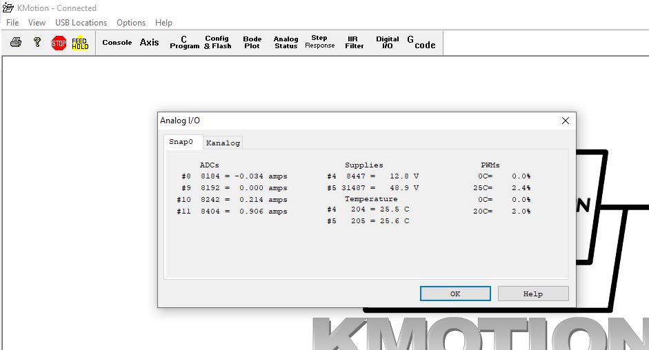

If I remove power from VS2, you can hear the the harmonic of the oscillators, of stepper motor #1 energize just as the voltage displayed in the Analog I/O window for Snap0 drops below 1.3V
It isn't clear what you mean. SnapAmp0 has two sides and voltages. Are you applying supply voltage to both sides of SnapAmp? What are the displayed voltages for each side before and after? When VS2 is removed what happens exactly?
SnapAmp has lots of diagnostic capability to tell you what is going on. The KMotion.exe Analog Screen shows the Supply Voltages and Current measurements for both coils of both stepper motors. Please tell us what the 6 values are before turning on VS2 and afterward.

"If I remove power from VS2, you can hear the the harmonic of the oscillators, of stepper motor #1 energize just as the voltage displayed in the Analog I/O window for Snap0 drops below 1.3V"
I do hear a high pitched whine when the snap amp is functioning. Somewhere I read the PWM is at 32khz, obviously humans cannot hear that, especially older humans :) So I assume I'm hearing a harmonic from the motor windings.
Even though the X axis is assigned to section "A", I can hear the frequency and feel a slight vibration in the shaft of Motor#1, when I try to index the "Z" axis. Probably noise getting into the input of Side A. But only when power is applied to VS1 only and "X" axis works!
When I connect the power supply to the VS2 input, the Analog I/O reads the proper input voltage of the power supply within .5% with a slight bobble. For instance when I have the 48volt supply hooked up both voltages read 48.1 to 48.3 volts. When I hook the 12 volt supply to either VS1 or VS2, the Analog I/O reads and displays the proper voltage.

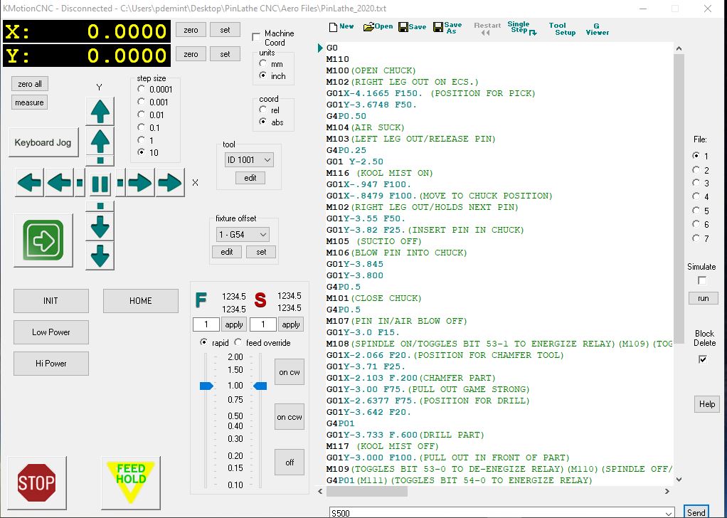

In anticipation of this, I used thread #1 to initialize the motors with a modified [SnapAmp 2 Steppers.c], I then use and assigned thread #2 as a low power setting and assigned it to "M5", and then thread #3 to "M6" to set the motors to high power for rapid movements, and then back down to a low value for slower travel speeds. I also had thread #4 as a simulated "HOME" which sets the machine coordinates X & Y to "Zero" in case this was some issue. I had planned later to write / adapt code to look for an inductive sensors for a real homing sequence. I also mapped these threads to user "Buttons" [INIT, High Power, Low Power, Home] for ease and quick access!

2axisBrushedRigidHomeAero.c
Thread 4
(2.68 KiB) Downloaded 260 times
Stepper_High Power.c
Thread 3
(147 Bytes) Downloaded 250 times
Stepper_Low Power.c
Thread 2
(145 Bytes) Downloaded 271 times
Aero_2axisStepperStartup.c
Thread 1
(3.02 KiB) Downloaded 255 times

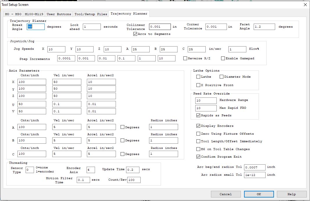

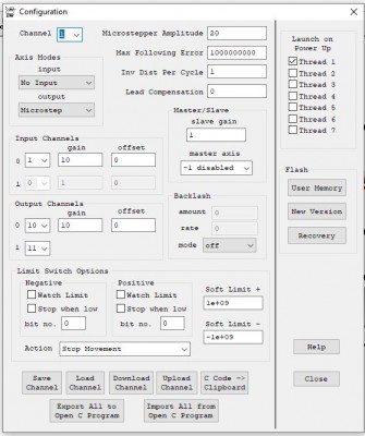

I don't see anything specifically that would explain Axis 0 not working.
The Screen shots don't really help if you don't explain under what conditions they were taken and what you did beforehand.
I would like to do the minimal steps that should work but don't and demonstrate the problem to simplify things.
Please don't run or include information on KMotionCNC until after you have your motors working in KMotion.exe its just a distraction.
We don't recommend Flashing anything into KFLOP. If you do then it is hard to know what state KFLOP is actually in. it seems you have Flashed KFLOP with something as Launch Thread #1 on Startup is set. Please reset KFLOP to its default state by Flashing New Version and do not Flash any programs or configuration into KFLOP.
I see the Initialization program has a few things that don't match the Configuration Screens:
-Output Gains are set to 10 instead of 1.
-Axis 0 is slaved to Axis 1.
-Axis 1 is slaved to itself (Axis 1).
-Various Stepper Amplitudes
-Various SlaveGains
