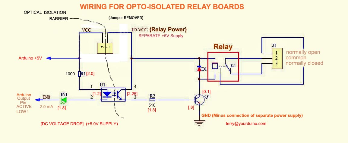

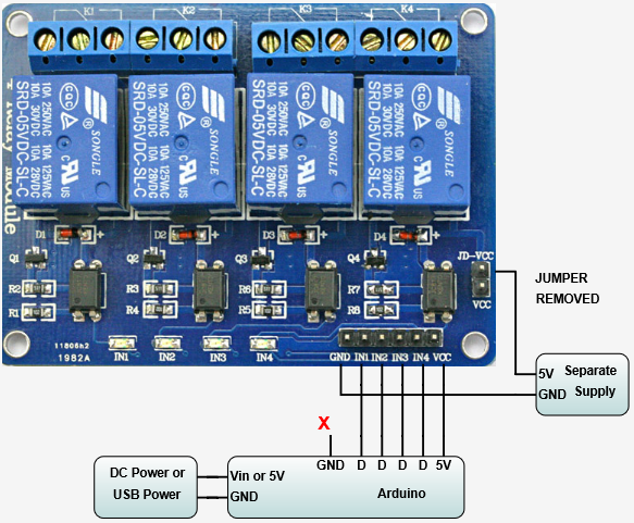

I have the DC power connected through the relay to and then the relay to the motor controller. The spindle uses a 7.5V DC motor supply.
I found further info on the relay. Please see below and pic attachments.
http://yourduino.com/sunshop//index.php ... tail&p=218
Thank you for your feedback.
Apologies, what do you mean the 5V and Rx are wrong, how should they be?
