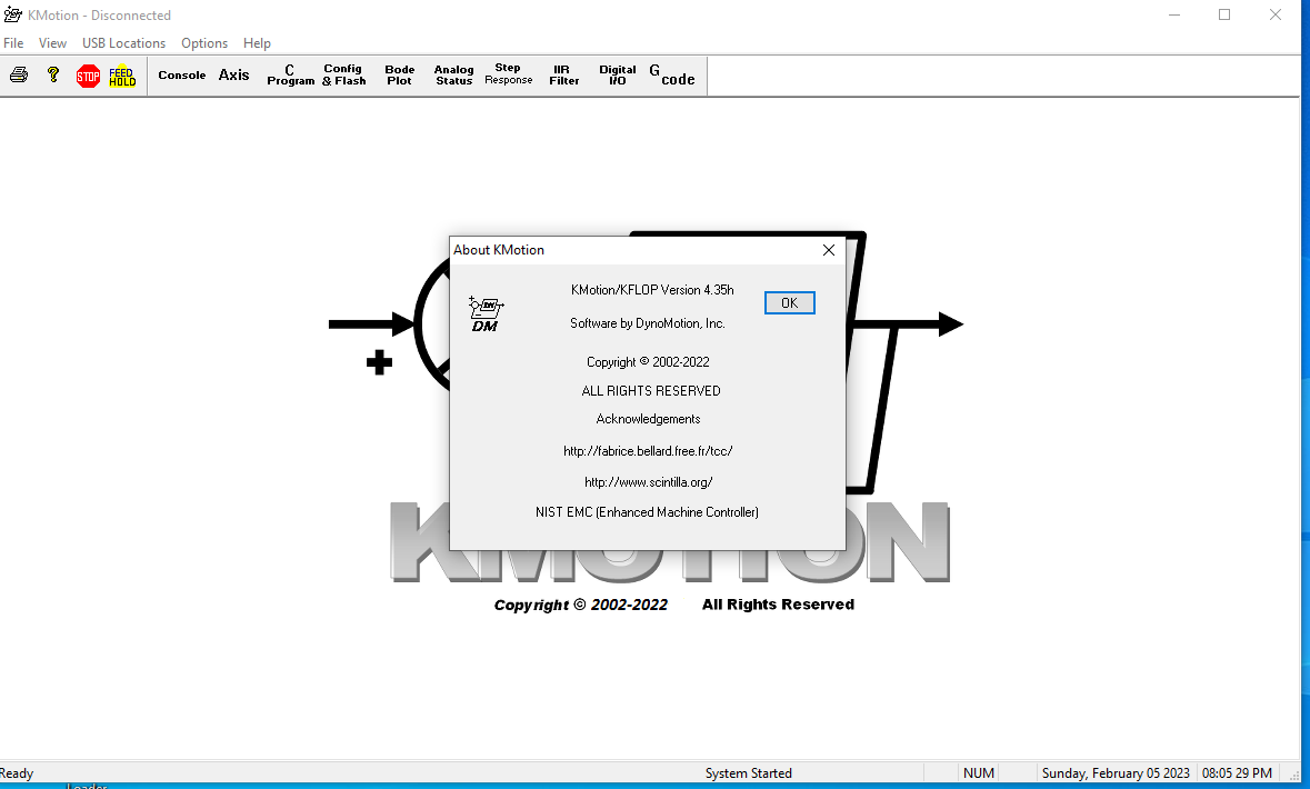

The machine is running windows 10 pro. I'll disable test mode, install 4.35h and try again soon. I have no idea why this PC was in test mode, it's not like I'm using it for driver development.

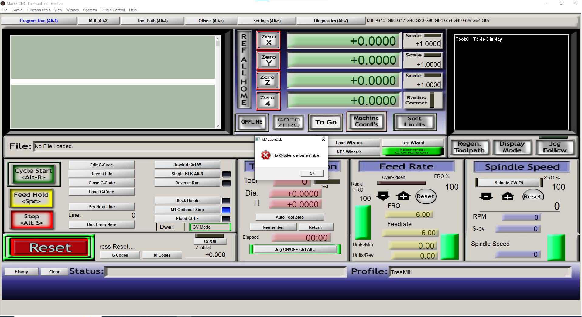

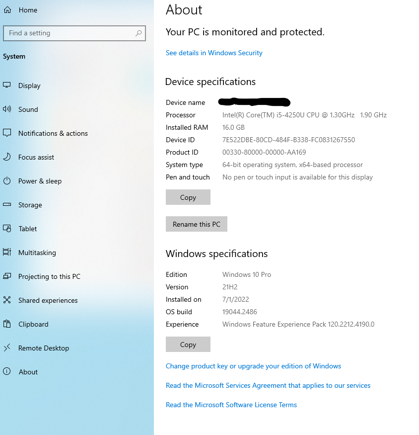

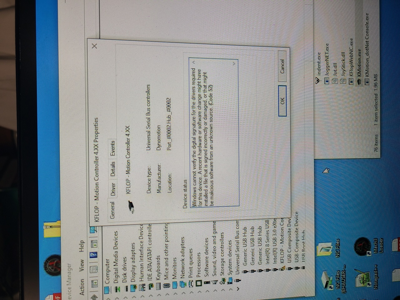

Re: Erratic Z motion Jogging though Mach 3
I installed 4.35h, but it appears that windows is unhappy with the driver if it's not in test mode. I've attached some images of the issue when out of test mode. I can also confirm that it is not the keyboard causing this issue. I may try replacing my USB hub next.
Brian
Brian
