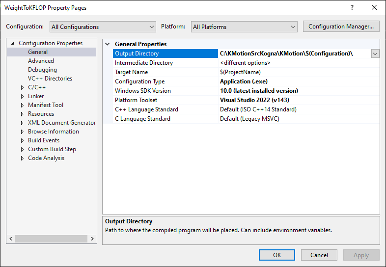

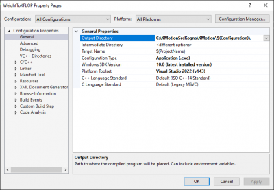

The normal reason for DLL not found is that your executable in not being placed in the folder with all the other binaries and dlls. Target your App to be in the \KMotion\Debug (or Release) of the KMotion Installation you are using in your project's properties. See below:

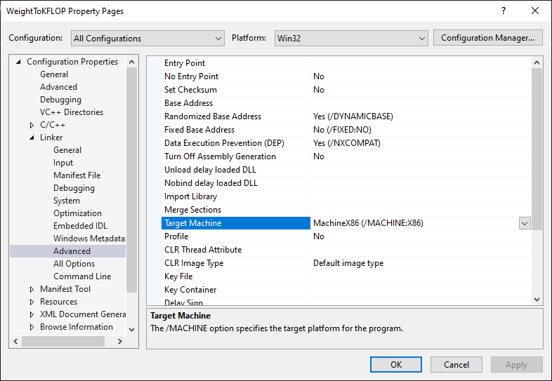

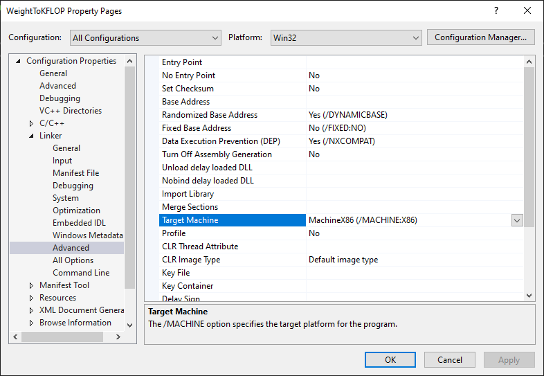

Another possible problem is your App is not a 32-bit (x86) App. See below:
