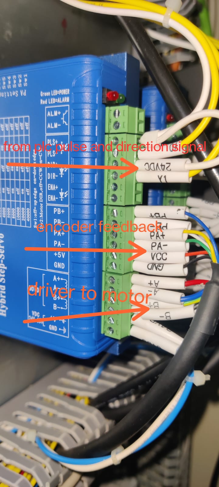

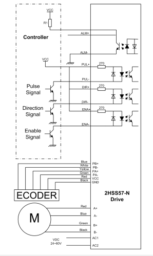

I have Kflop board and kstep board. using those boards we tried operating 3 stepper motors. But Now we bought 3 Step Servo Motors along with its drivers (57J1880EC-1000 with 2HSS57 (Maxima Stepservo Motor with Encoder)). In this image the motor has two wires one is used for motor supply and other wire is for encoder feedback. This is the circuit diagram of our motor driver.
we usually transmit pulse output and motor direction signal from PLC to driver and then driver take care of the closed loop system. so what im trying to say is i need an pulse output and direction signal either from kflop or kstep to control my driver. i have mentioned some details in above image.please go through it also.
My Question is whether it is possible to operate my motor either with or without its driver using Kflop.
If its possible may i know how to connect our motor with kstep

KFLOP should be able to provide Step/Dir signals to those drives using KFLOP's 5V open collector (common anode) mode. See here. Note your wires show +24V connected to the Drives. This should be changed to +5V or there may be damage to KFLOP.
KStep would not be needed.

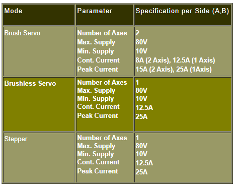

is it possible to run 4 servo motor(closed loop) with 1 snap amp orelse we need two snap amp.Each side (A, B) has 4 half bridge amplifiers capable of driving either:
1 stepper motor
1 brushless motor
2 brush motors

It depends on the type of servo motor. 1 SnapAmp can drive (4) DC brushed Servo Motors or (2) 3-phase brushless DC Servo Motors.is it possible to run 4 servo motor(closed loop) with 1 snap amp orelse we need two snap amp.
I don't understand the question.Is it mandatory to use separate drives for each motor or else the servo motor and its differential encoder can be connected directly.
Is there any servo voltage and current we need to aware to connect with snap amp.
