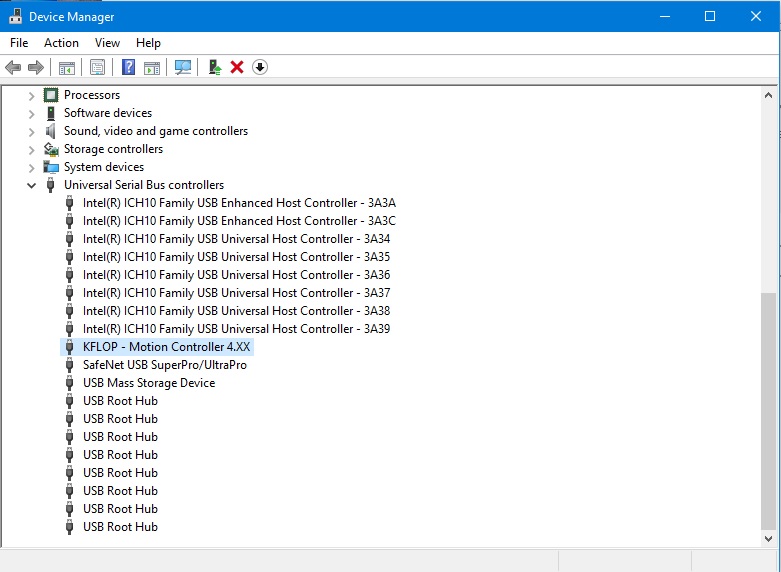

Post by RogerFroud » Mon Aug 16, 2021 1:03 pm
I've finally got the right FTDI chip fitted and programmed, it now shows up in the Device Manager as shown in the attached picture.
I've right clicked on that and pointed it to the USB driver, and it tells me that the best driver is already installed. That USB port works fine with the new board I've received, so that's not surprising. However, it says 'Can't Connect to KMotion Board 0x31 when I try to communitate with it.
I've selected Board 0 @ 0x31 using KMotion->USB Locations.
So to summarise, I get the exact same boot sequence on the good and bad boards showing with the flashing LEDs on bootup, finishing with both LEDs on. I can see it in the Device Manager, but something else is preventing it connecting.
Is there anything else in the setup that I'm missing? It seems like it's doing all of the right things, I'm surprised this doesn't work now?

Posts: 2927
Re: Damaged KFLOP
Post by TomKerekes » Mon Aug 16, 2021 2:23 pm
Hi Rodger,
Is the USB location 0x31?
You might try Flash Recovery.
Otherwise possibly a bad solder connection between the FPGA and USB chips?

Post by RogerFroud » Mon Aug 16, 2021 7:18 pm
Many thanks for that, I've found a bad joint on one of the data lines to the FTDI chip, so it now communicates correctly with KMOTION.
All that remains is to hook it all back up to the KANALOG board and see if it now functions as a complete system.
Before doing that, I'll bus out each pin on the FPGA to make certain that every pin does connect to the pad it's supposed to be soldered to.
