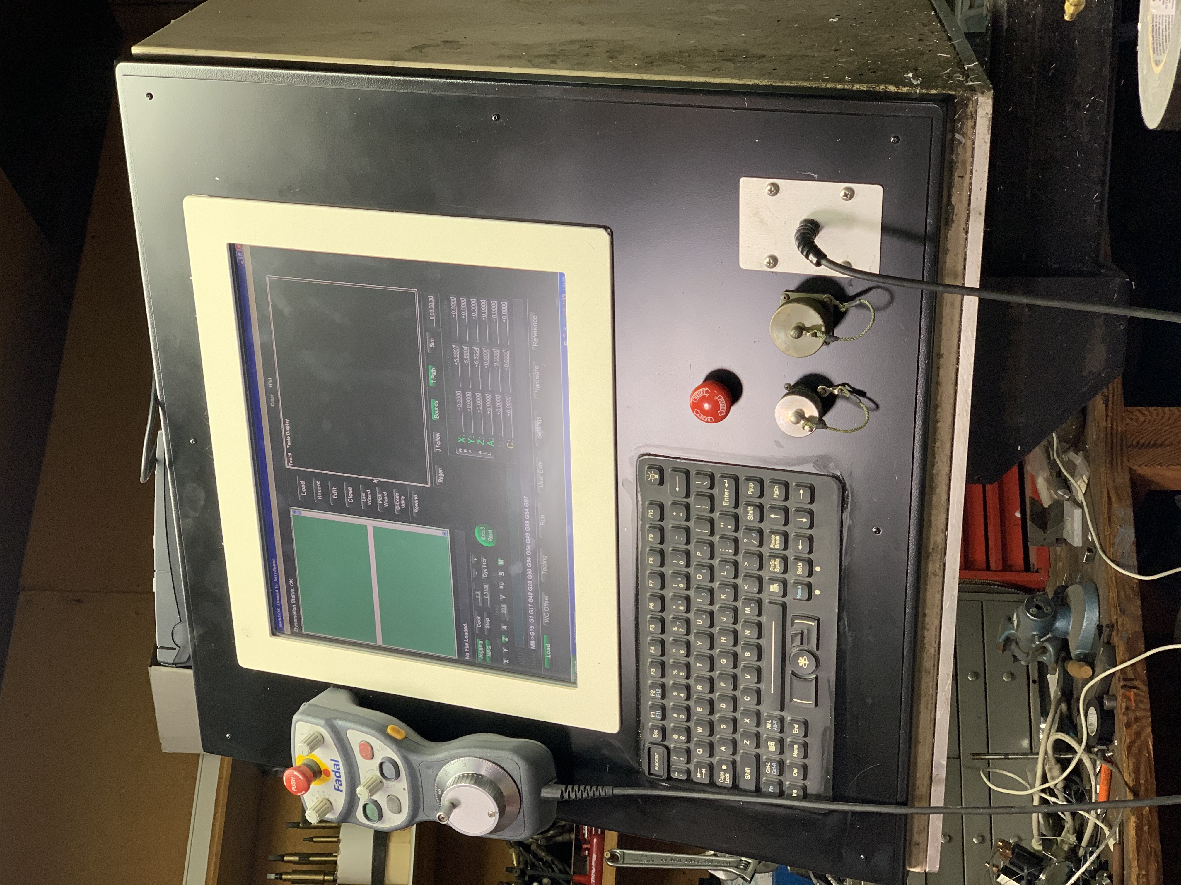

Post by macona » Mon Sep 28, 2020 8:03 pm
Pic of my controller.
