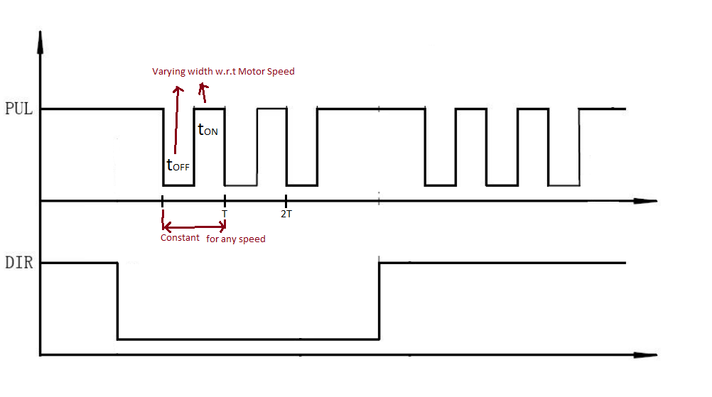

PFA waveform image for all conversation below
2. Step Frequency controlled by varying the Step pulse width right?
3. For controlling the motor speed, only Pulse width should varies and keeping “Time Period T” (and or Pulse input frequency F=1/T) is constant right?

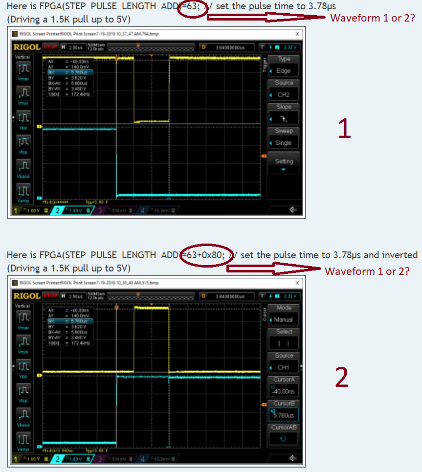

“FPGA(STEP_PULSE_LENGTH_ADD)=42;”
Diagram seems incorrect. Normally 'Ton' refers to the active pulse. Only the inactive time varies.
No. Step Frequency is controlled by varying the time between pulses.
No.

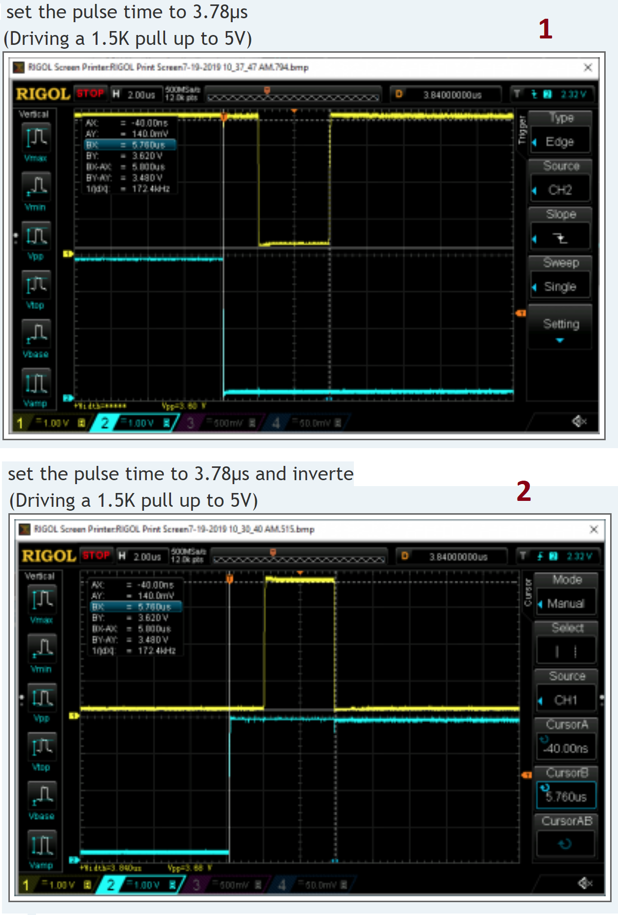

4. What is the minimum and maximum Pulse input frequency ranges can be set?
KFLOP can output pulses from 0Hz - 2.5MHz
5. “60nS to 3.78uS” is the Step Pulse Width(tON) or Step Pulse Period(Time Period)?
It is the Step Pulse Width. In your diagram it would be Toff

10. If STEP_PULSE_LENGTH_ADD)=1 what is the Pulse width(t_ON), Low Width(t_OFF), Pulse period(T) and Pulse input frequency?
This sets the Step Pulse Width to 60ns. The time between pulses and the Period depend on what speed the motor is commanded to move.
Can we set to 1? because, as you told “maximum Step Rate of 2.5MHz”? or else give the example with maximum frequency (with decimal value) we can set.
Yes. At 2.5MHz a pulse will occur every 400ns. Therefore the Step Pulse Width should be less than 400ns in order to have any time between pulses. Most Drives and cables will not work at these rates but KFLOP is capable of working at these rates.
11. If STEP_PULSE_LENGTH_ADD)=63 what is the Pulse width(t_ON), Low Width(t_OFF), Pulse period(T) and Pulse input frequency?
The Step Pulse Width will be 3.78us

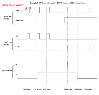

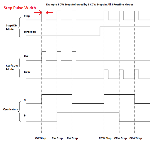

15. Step Size mean Pulse Width(tON time) right?
No. Step Size is the amount the motor moves for each Step Pulse. For example with a stepper motor that has 200 Full Steps/revolution and 16X microstepping then the Step Size will be 1/3200 of a revolution.

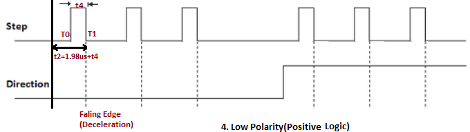

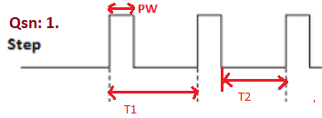

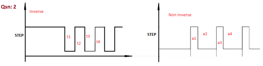

1. “Time between Pulse” which one is correct T1 or T2 or both in the waveform?
1. Time bw Pulse.png (7.49 KiB) Viewed 5531 times
“Diagram seems incorrect. Normally 'Ton' refers to the active pulse. Only the inactive time varies.”

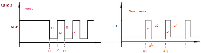

2. In Inverse Diagram: t1, t3 is t_ON and t2, t4 is t_OFF right?
In Non-Inverse Diagram: a1, a3 is t_ON and a2, a4 is t_OFF right?

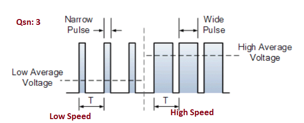

1. “In some examples have explained, motor speed will be controlled by controlling only the Duty cycle and Frequency/TimePeriod is remains constant. PFA image 3 -found in website.
2. And in some examples motor speed will be controlled by controlling the frequency. Here both Duty cycle,Pulse Width(t_ON), t_OFF and TimePeriod all will varies.”
3. Which one is correct? Both correct? or any other method can also be implement?

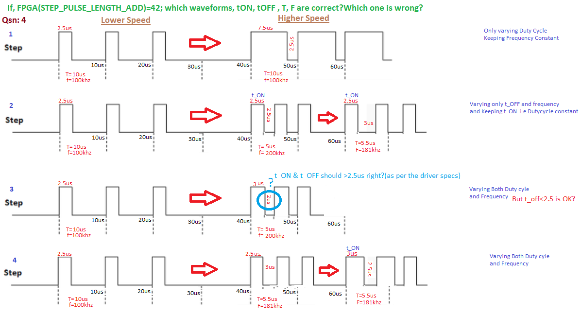

4. PFA the wave forms variation in Low speed and High Speed for setting “FPGA(STEP_PULSE_LENGTH_ADD)=42;”
Kindly tell us which is correct and wrong as per the comments on the image?
42 sets the Step Pulse Width. To move at different speeds the time between pulses varies.”
5. In “42”, Pulse Width=t_ON=2.5uS,in this case, Time between pulses varies only by varying either t_ON or t_OFF or both(Time period) right?
6. For increasing the speed, the number of pulses per second should increase and not the pulse width time right? Or both will do?
7. In “42”, Pulse Width=t_ON=2.5uS, t_On is constant for both low Speed and Higher speed or it should varies?
8. In “42”, Pulse Width=t_ON=2.5uS,t_on i.e pulse width will goes less than 2.5uS for varying the speed?
9. In “42”, Pulse Width=t_ON=2.5uS, mean we are defining the minimum Pulse Width or Maximum Pulse width or we are limiting the Frequency.
10. In “32”, Pulse Width=t_ON=2uS, As you told frequency should be depends on the input commands, Then how you calculate in the manual “1/(2 x 2us) = 250KHz.” Can we refer this calculation or its not applicable?
Thank You
AMIT KUMAR

1 - it can be defined either way
2 - yes if that is how you want to define them
3 - doesn't apply. You are confusing Pulse Width Modulation (PWM) with Step/Direction
4 - #2 seems correct
5 - only Toff varies
6 - only pulses/sec will increase
7 - Pulse Width never changes
8 - Pulse Width never changes
9 - Pulse Width never changes
10 - doesn't apply. You are confusing Pulse Width Modulation (PWM) with Step/Direction

Yes, I was confusing PWM. And now I understand PWM method is only for DC Motors and for stepper motor we don’t use PWM. Thanks for your advice.
So the Pulse width(T_ON) remains constant for any Speed, but the Duty cycle, T_OFF, Time period, Frequency will be changing with respect to the Motor speed.
1. I have bit confused, Inverse Signal mean polarity should be higher level and it actives at lower level right? You have advised the inverse and non inverse settings with waveform. kindly check whether its correct or waveform was interchanged?
2. In NON INVERSE waveform, a1,a3 is T_ON and a2,a4 is T_OFF.A1 is raising edge and A2 is Falling Edge right?
In INVERSE waveform, t1,t3 is T_ON and t2,t4 is T_OFF right? Which one is raising edge and Falling Edge?

1 - The scope plots are labeled correctly as to what KFLOP does. Active high or Active low depends on your system. You can always check this yourself with a voltmeter.
2 - Rising and Falling terminology is probably a poor choice of words. 'Beginning' or 'ending' of the pulse might be better. Or 'leading' or 'trailing' edge of the pulse might be better. The idea is to use the polarity so your Drive "steps" at the end of the pulse so it has the maximum Direction setup time. This is the 5.76us measurement shown in the two scope images.

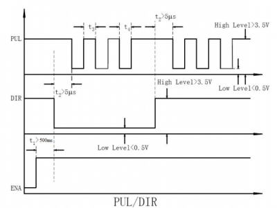

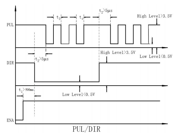

Specification of our Drivers are
https://www.leadshineusa.com/productdet ... el=cs-d508
Step Pulse: > 2.5uS
Pulse input Frequency: < 200KHz
Direction setup time: > 5uS
PUL/DIR Voltage level: 4.5-5V for voltage HIGH, 0-0.5V for voltage LOW

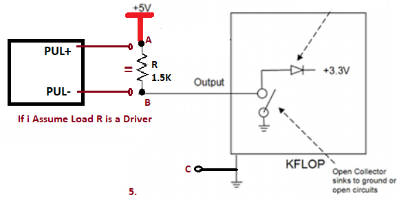

(Open Collector Driver connected to KFLOP JP5 and JP7)
1. Kindly advice which one have to use for the above specification/Waveform, “FPGA(STEP_PULSE_LENGTH_ADD)=XX;” or “FPGA(STEP_PULSE_LENGTH_ADD)=XX + 0X80;” ? Kindly advice the XX value also.
2. In the driver which switch we have to enable either Falling or Raising switch according to your recommended settings in 1?
3. Kindly Suggest all the better Configuration Settings we have to do for the above Driver Specification in the firmware.
T1, A1 is Beginning edge and T2,A2 is Ending Edge.
4. But, Its important because in the driver need to enable the Raising or Falling Switch. Kindly advice Which one I can consider Raising and Falling in the diagram.
5. So, We are defining only T_ON in the firmware and it is constant. T_OFF and Frequency/speed is only depends on the User inputs i.e RPM on the KMOTION right?
Thank You
Thank You
AMIT KUMAR

Hi Amit,
1,2,3,4 - use XX = 63 to obtain > 5us Direction Setup Time.
The polarity will determine on which edge the Leadshine steps on. You would need to determine this as it is not clear to me from the specification. You can test from the Digital IO Screen. Or just try both ways.
5 - correct do not go too fast to exceed the allowed step frequency and violate the timing requirements:
1/(3.78us + 2.5us) = 159KHz

1. As you sent the below waveforms 1,2,3, kindly confirm the measured points in the KFLOP to get the waveform on the Oscilloscope:- Its a Point A with respect to B or Point B with respect to C on the image 5 below?
2. For measuring the PUL/DIR Voltage level by multimeter, Measuring point will be "PUL+ w.r.t PUL-" or "PUL- w.r.t GND"? Because we are getting different reading. Which point is correct?
3. KFLOP also supports for Common Cathode (PNP Signal)? Is “LVTTL-step/Dir” is a Common Cathode?
4. Both Waveform 1 &2 above is an Open collector configuration?
5. As driver Manufacturer said, Low Polarity (Inverted) Pulse (Fig2) is a common Anode and High Polarity(Non Invert) signal (Fig 1) is Common Cathode configuration. Is this true? Both configuration provides different Polarity?
6. For FPGA(STEP_PULSE_LENGTH_ADD)=XX; Initially i.e before pulsing(No Pulse) the I/O switch on the KFLOP(Fig 5) is opened or closed(Grounded)?
7. For FPGA(STEP_PULSE_LENGTH_ADD)=XX+0x80; Initially i.e before pulsing(No Pulse) the I/O switch on the KFLOP(Fig 5) is opened or closed(Grounded)?
