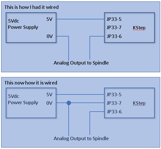

It isn't clear to me that you have an Analog GND connection from KStep JP33 pin 7 to the 5VDC power supply GND. Or where your meter GND is connected. Maybe draw a diagram.
I like the idea to eliminate the Spindle from the picture. Just apply a voltage such as a +9V battery to Analog Vcc (pin5) and Analog GND (pin7). Then measure Analog Out (pin6) with a volt meter relative to battery GND. Then perform the test in my previous email.

So my mistake was not connecting JP33-7 to PS ground. I looked at the KStep connector info but interpreted that if I was using it as a pot simulation I would need to connect the PS ground to pin7. I attached a wiring diagram...
So one more question, my preference would be to use a PWM output, however it appears that only an analog output is available through JP33. Am I correct? If not, what would be the connectivity.
Jerry
