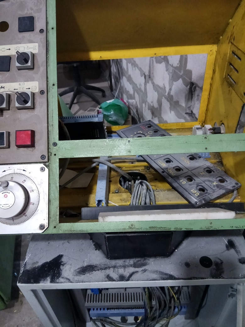

Post by Musienko_D » Thu Jan 17, 2019 8:19 pm

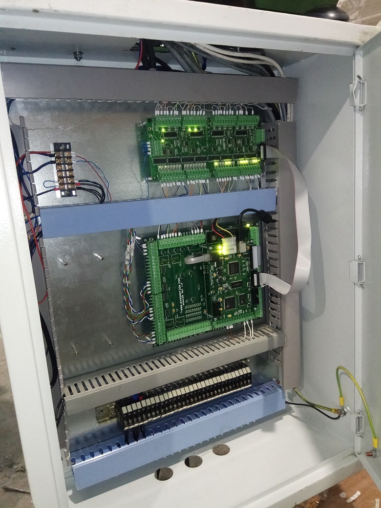

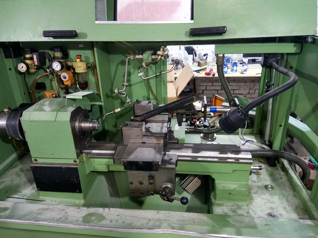

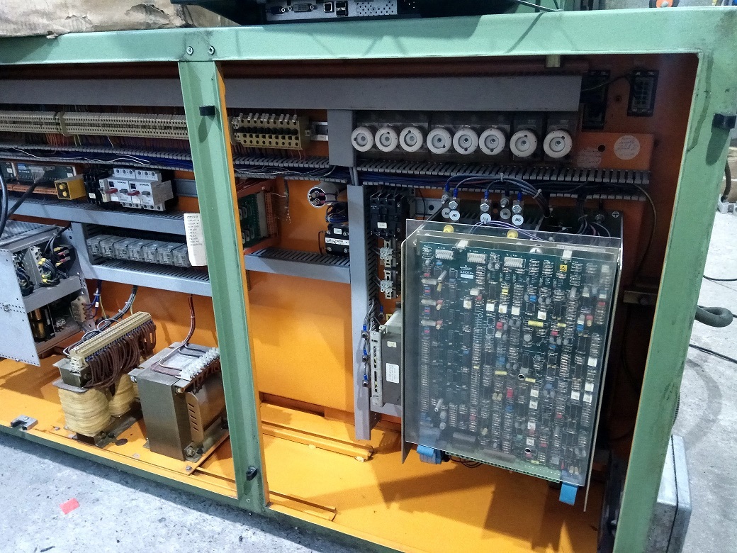

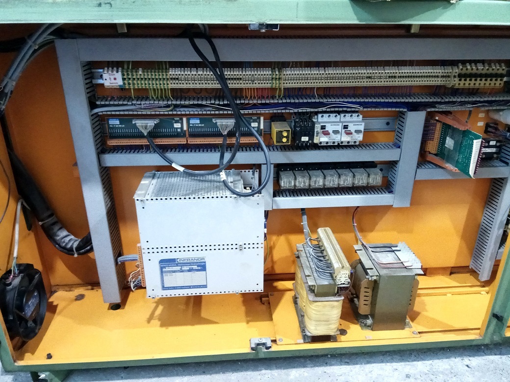

Modernization of the lathe machine Schaublin 102 cnc
After cleaning

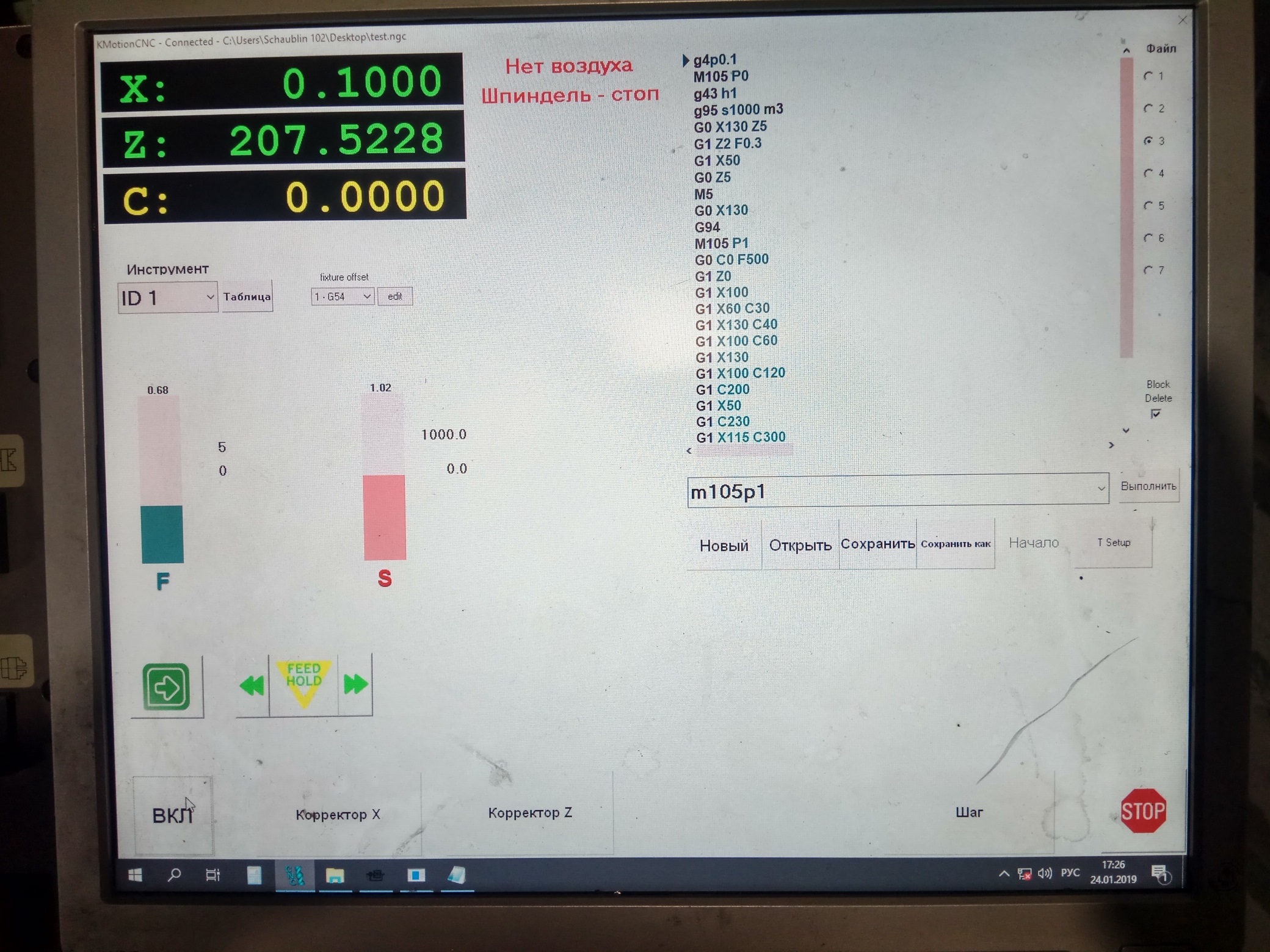

Post by Musienko_D » Fri Jan 18, 2019 7:06 pm
First test

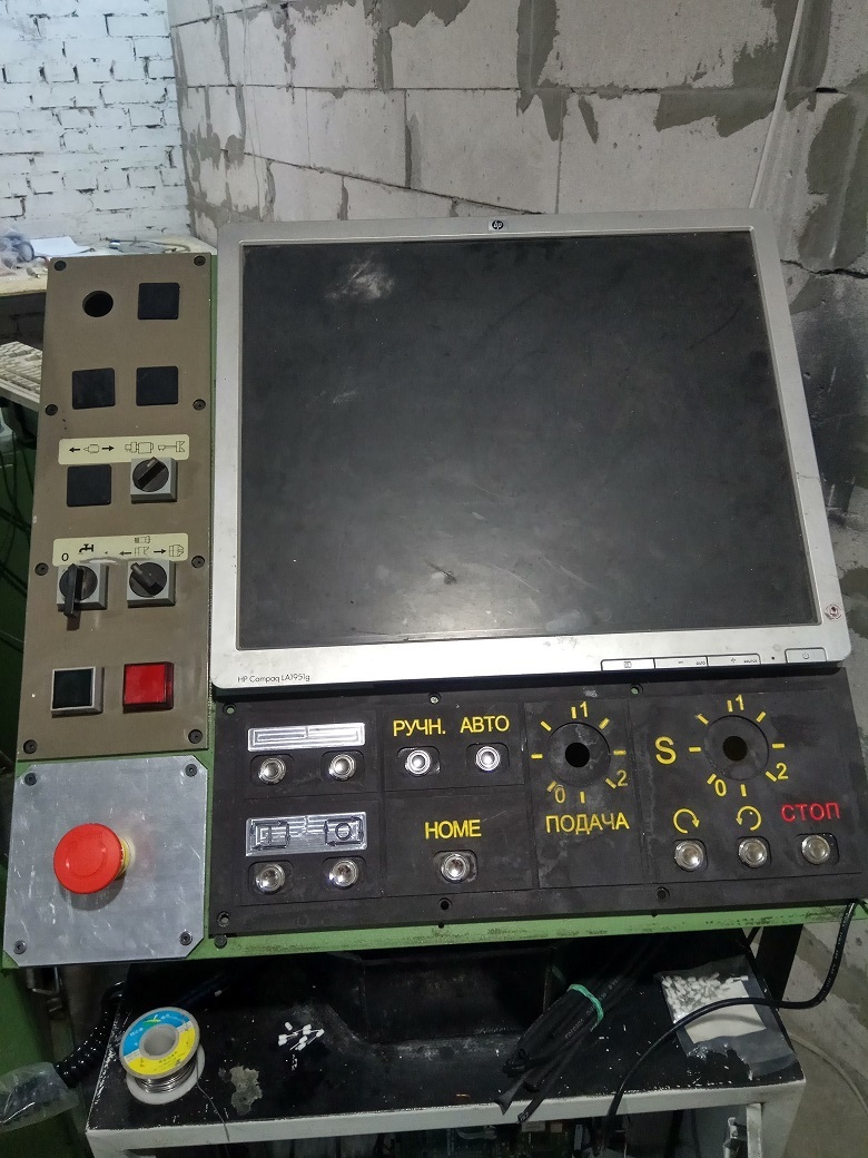

Musienko_D
Posts: 5
Joined: Thu Dec 13, 2018 8:47 pm
Re: Schaublin 102 cnc
Post by Musienko_D » Fri Jan 18, 2019 7:15 pm
The spindle can work as a rotary axis, the mode will switch according to the M command.
It remains to replace or add the encoder on the spindle, the resolution is too low.

Nice work. Thanks for sharing. I like your simple Screen.
Post by Musienko_D » Mon Jan 21, 2019 9:27 pm
TomKerekes wrote:
Sun Jan 20, 2019 7:18 pm
Thank.
The machine is controlled by external buttons, on the monitor only the display of the necessary information.
Now added VertBar, but not enough horizontal bar scale.
