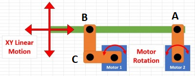

I am building a spray robot and dont want to use ballscrews inside the booth. The nonlinear kinematics package looks very promising. I have read the kinematics wiki page, but dont really understand and would like help walking through the problem. My motion is only on the X/Y axises, and I plan on using a 4 bar linkage hooked up to two stepper motors. I have attached an image.
You can see that combined motion between the two motors can move the tip of the linkage in the X and Y directions. My next step was to make an equation that given X and Y values, I can solve for the two motor angles.

Hi Scott,
That looks interesting.
I think I see one solution:
#1 Given xy position and Motor 2 position point A (see diagram below) can be found by solving the intersection of 2 circles. The Kinematics class has a function to do this CKinematics::IntersectionTwoCircles
#2 Weighted average of point xy and point A can be used to determine point B
#3 Given point B and Motor 1 position point C can be found using the intersection of 2 circles.
#4 Compute Motor 1 angle from C
#5 Compute Motor 2 angle from A
1. What do I do with this equation?
Create a new Kinematics Class with an appropriate name and change the TransformCADtoActuators function to perform the Transformation.
