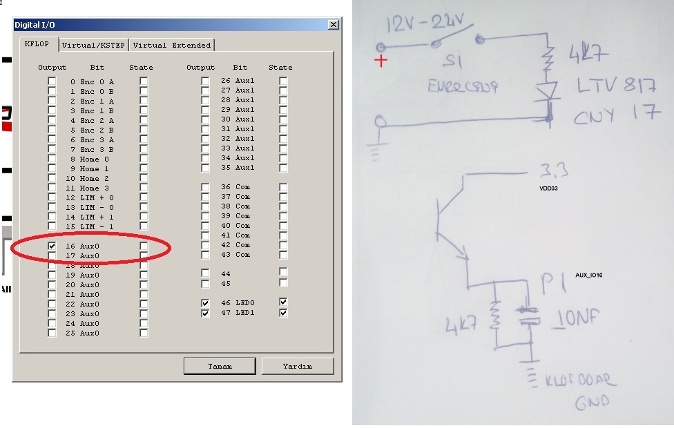

I open kmotion I/O page right under side when I click led 1 and led 2 on / off I see on the board leds on off. Can ı say board is connecting? or how can I check connecting

I add foto I/0 foto of bit 16. This is right?

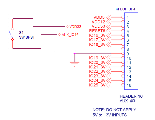

if you draw basicly electronic. I can do it. ( after next time I will convert to 24volt machine system not now) I am not engineer, I'm a user.
It is likely you will have noise problems using 3.3V inputs. But here is a diagram:
I think you forgot the photo

Could you draw circuit limit switches jp 7 will also apply what is the pin number and simple connection. positive and nagative X Y Z.
JP4 and JP6 each have 16 3.3V inputs with 150ohm pull down resistors. Use those instead of JP7 because to interface to a switch a pull up or pull down resistor is required and JP7 do not have pull down resistors.

Hello Tom
I add drawing about emergency stop. Thats right drawing?
Can I use same drawing for Limits swithc and home swithc?
Can you share Limits pins and home pins? ( will we use JP4 and JP6 pins) and whats the pin numbers?
I forgot to add foto now I added. for bit and Drawing
Many thanks for patience
