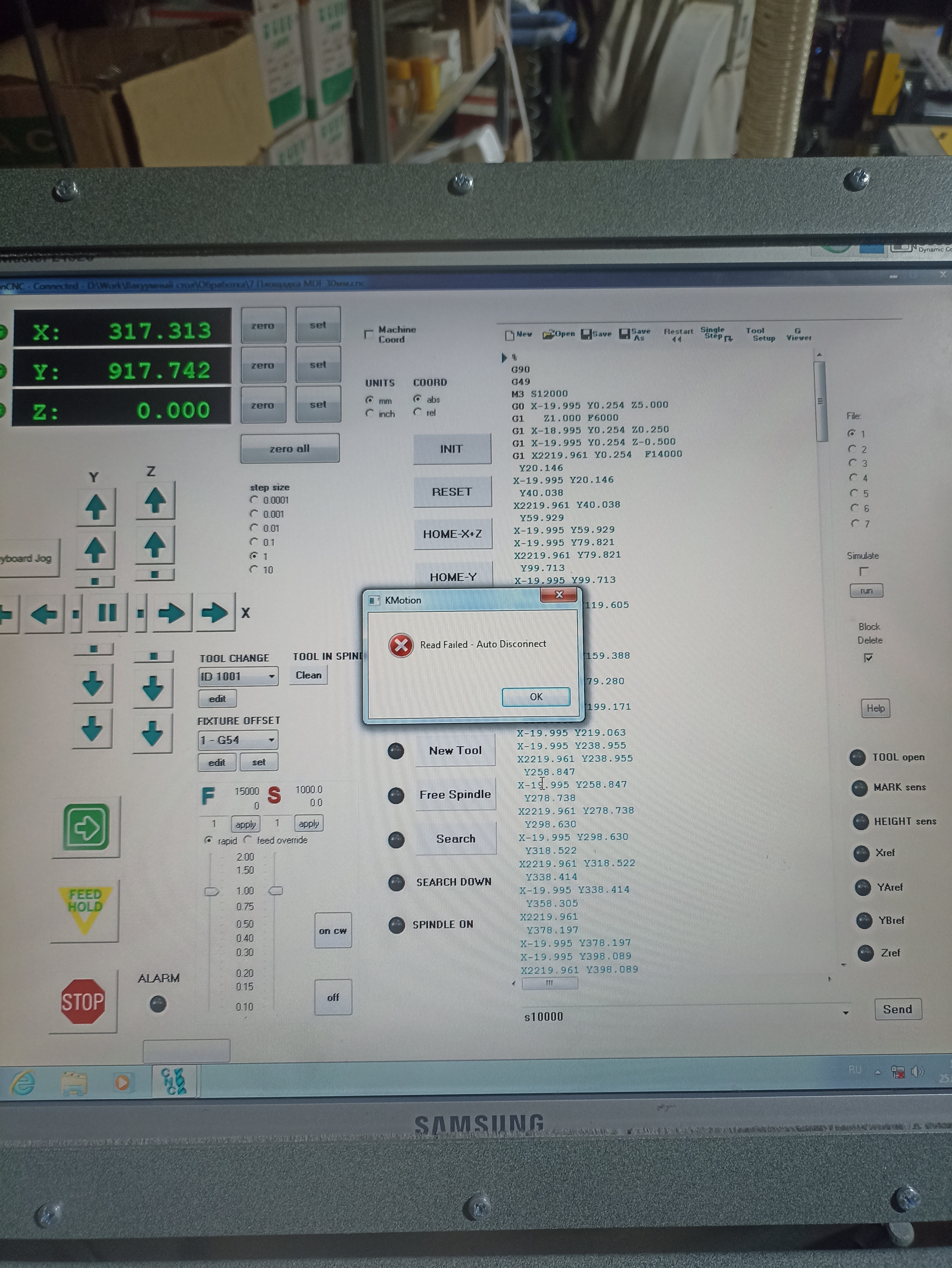

Hi Tom.
I just can't get this to work.
I think the board is being reset.
During a tool change, the program freezes and after a while reports a connection error. During milling, an error appears at different times and stops work. Regards,

Hi Taras,
What is your Tool Change doing?During a tool change, the program freezes and after a while reports a connection error.
It is indicating the axes are disabled. Are they? Run KMotion.exe and when the error occurs check for any messages on the Console Screen.During milling, an error appears at different times and stops work.

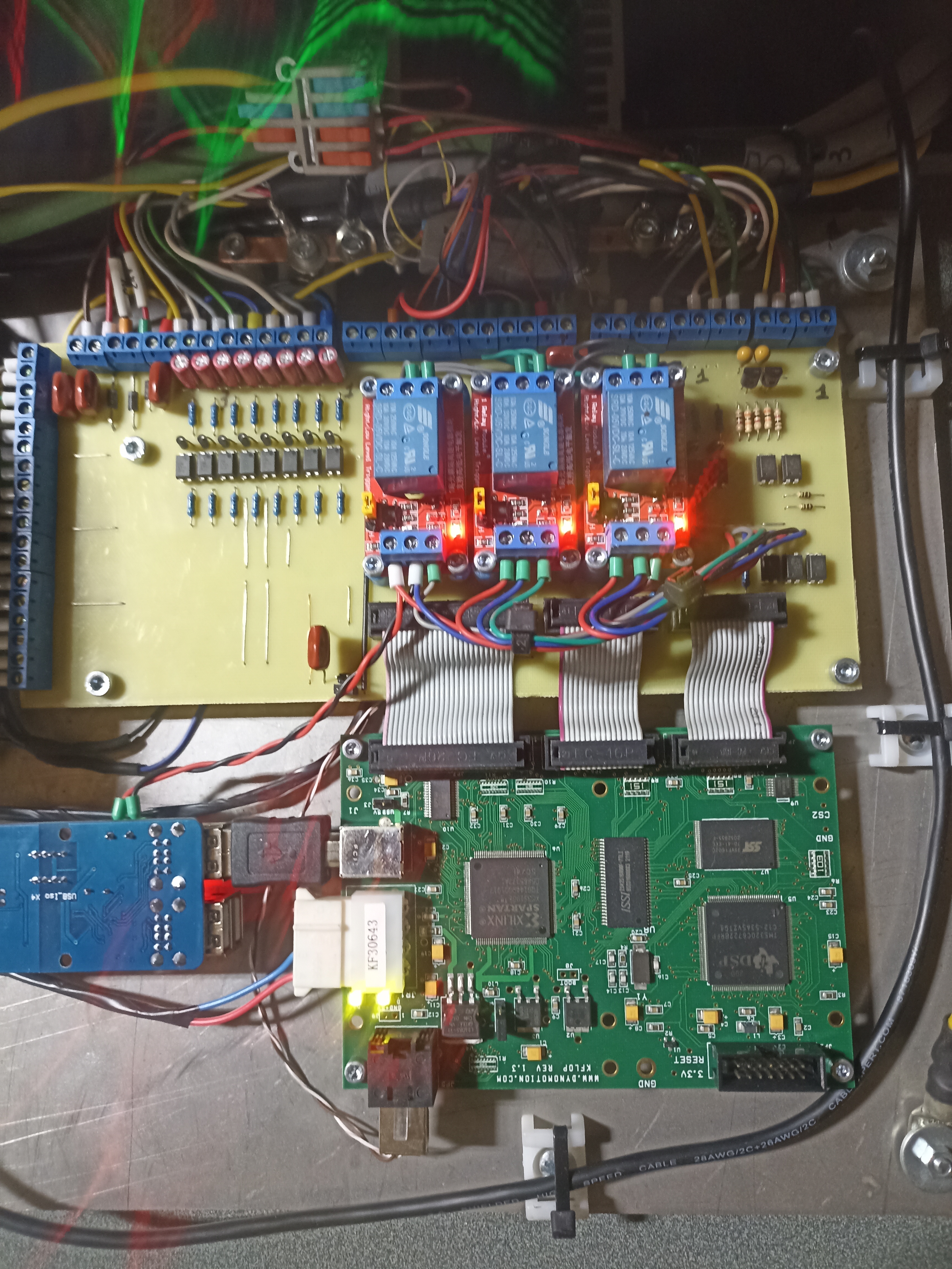

I found the reasons why the automatic tool changer did not work.
The problem occurred when the chip brush lowering valve was turned on.
I installed freewheeling diodes in parallel with all valve windings and the problem disappeared.

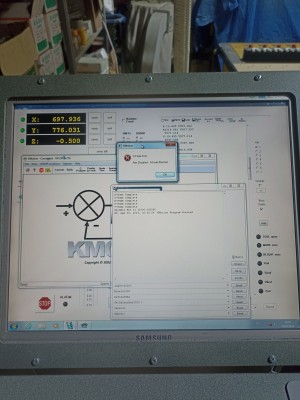

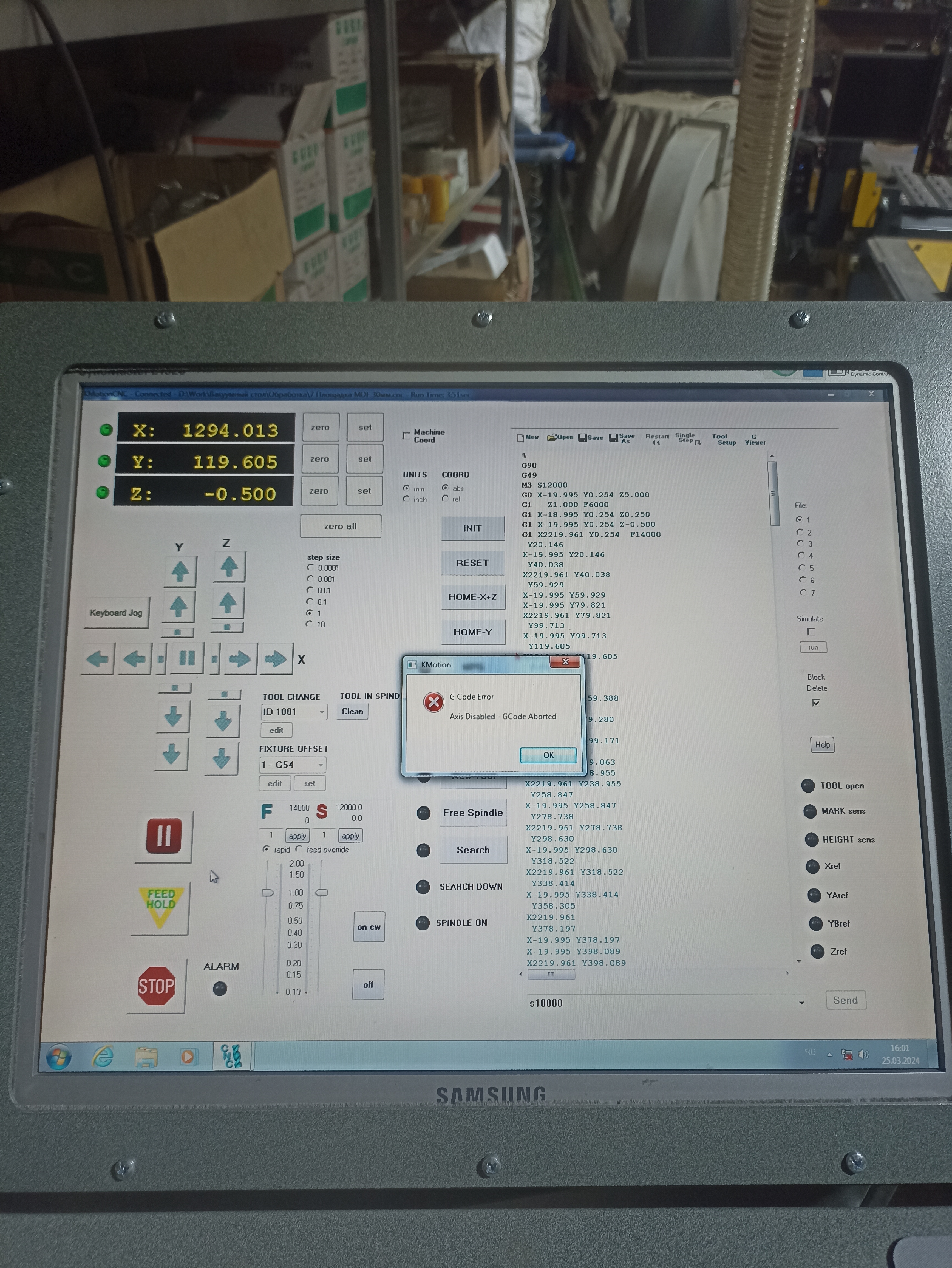

Re: Reset kflop board
It doesn't seem to be an issue with USB or "turning off" or there would be a disconnect message.
Instead it says "Axis Disabled". Are the Axes disabled? Check with the KMotion Axis Screen. Do you have anything that would disable the axes?

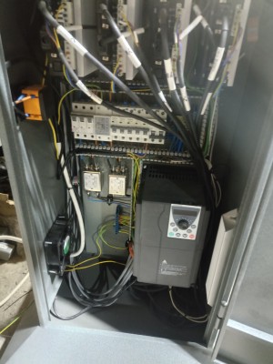

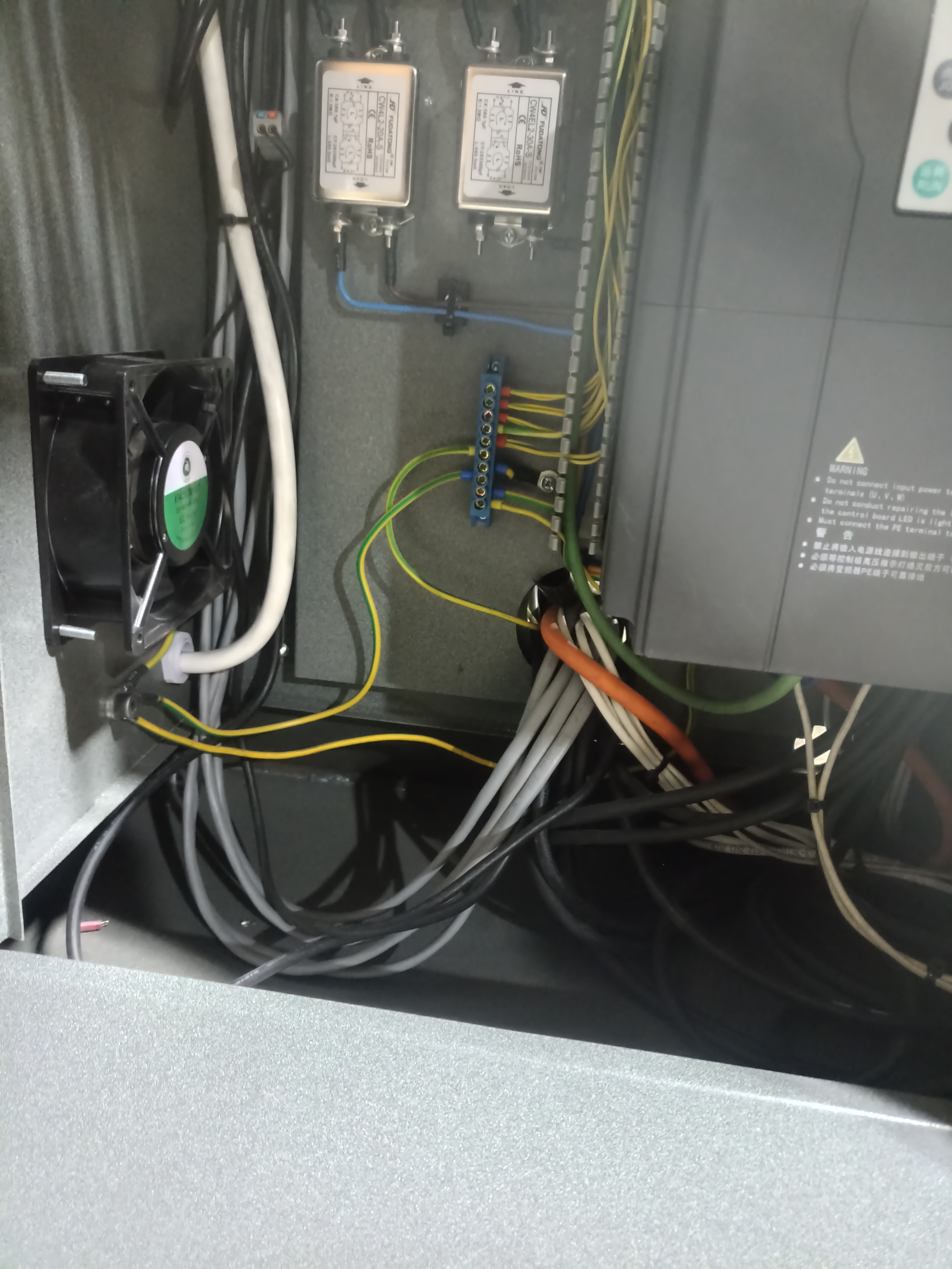

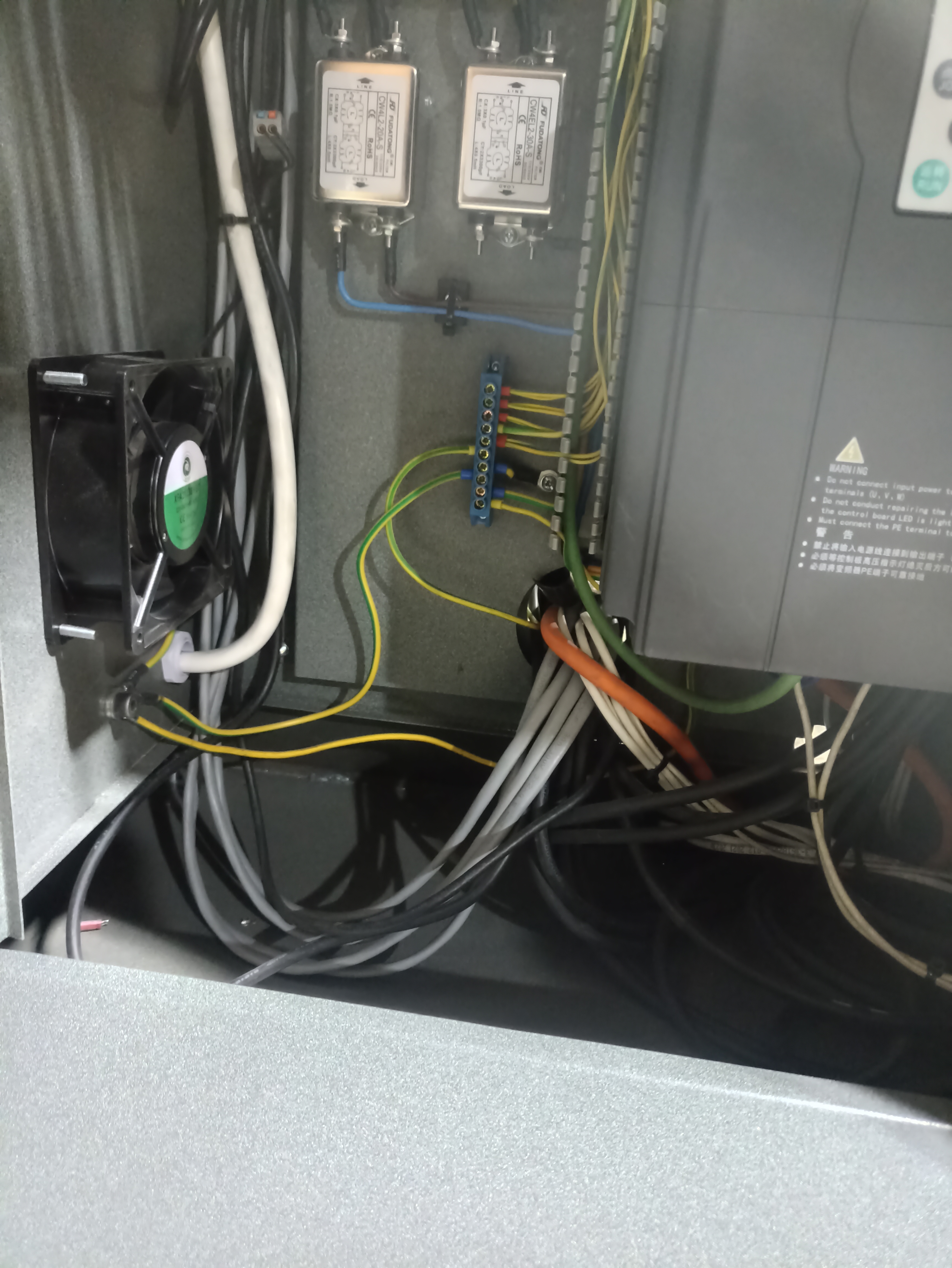

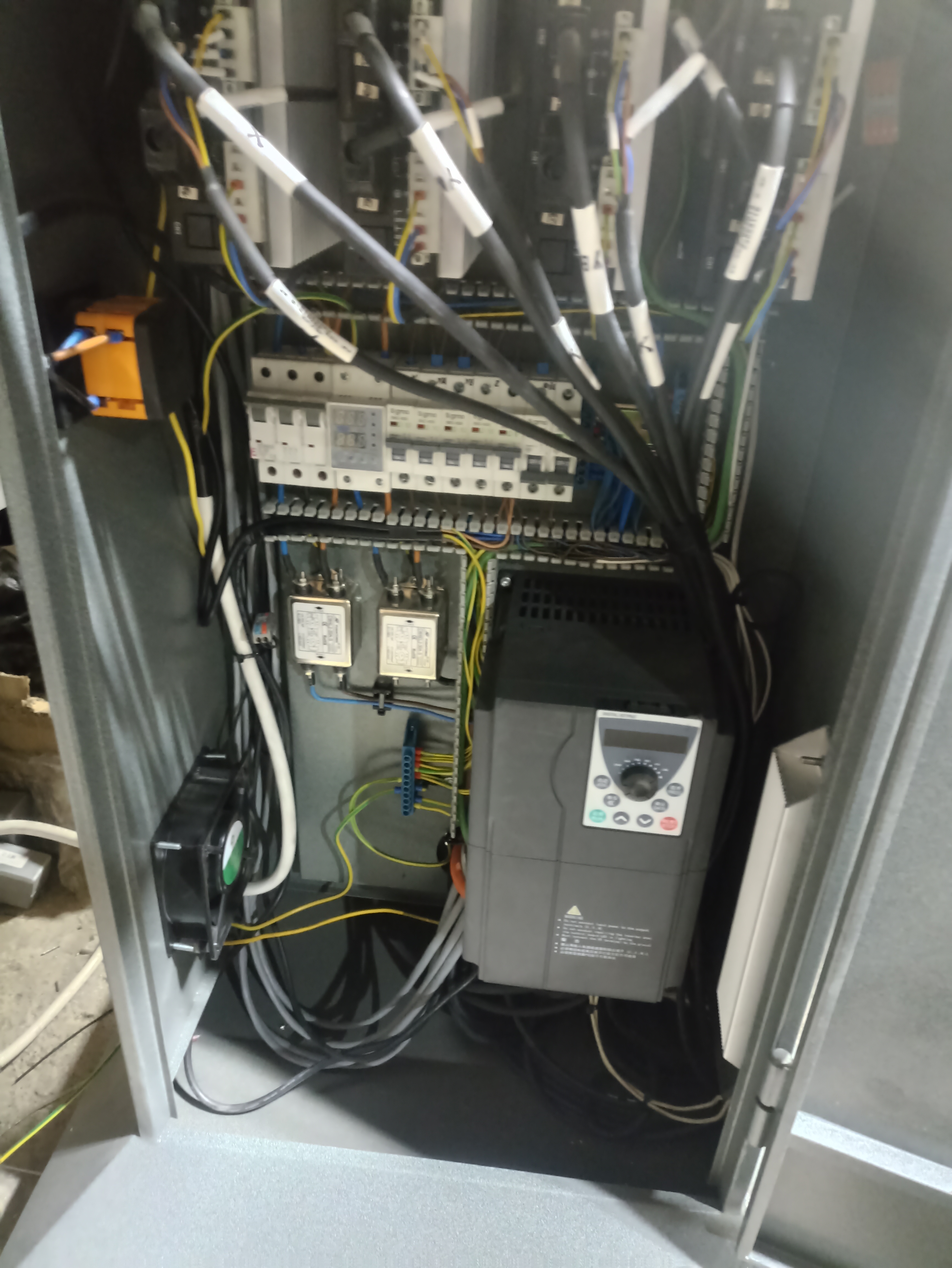

The problem turned out to be the EMI filter.
After replacing the filter, the stops disappeared.
The only thing that remains unclear is why the program did not produce any errors but simply stopped citing a G code error?

Hi Taras,
The reported error was "Axis Disabled". The GCode stopped because an Axis was disabled. That's why I asked you to post those things.
