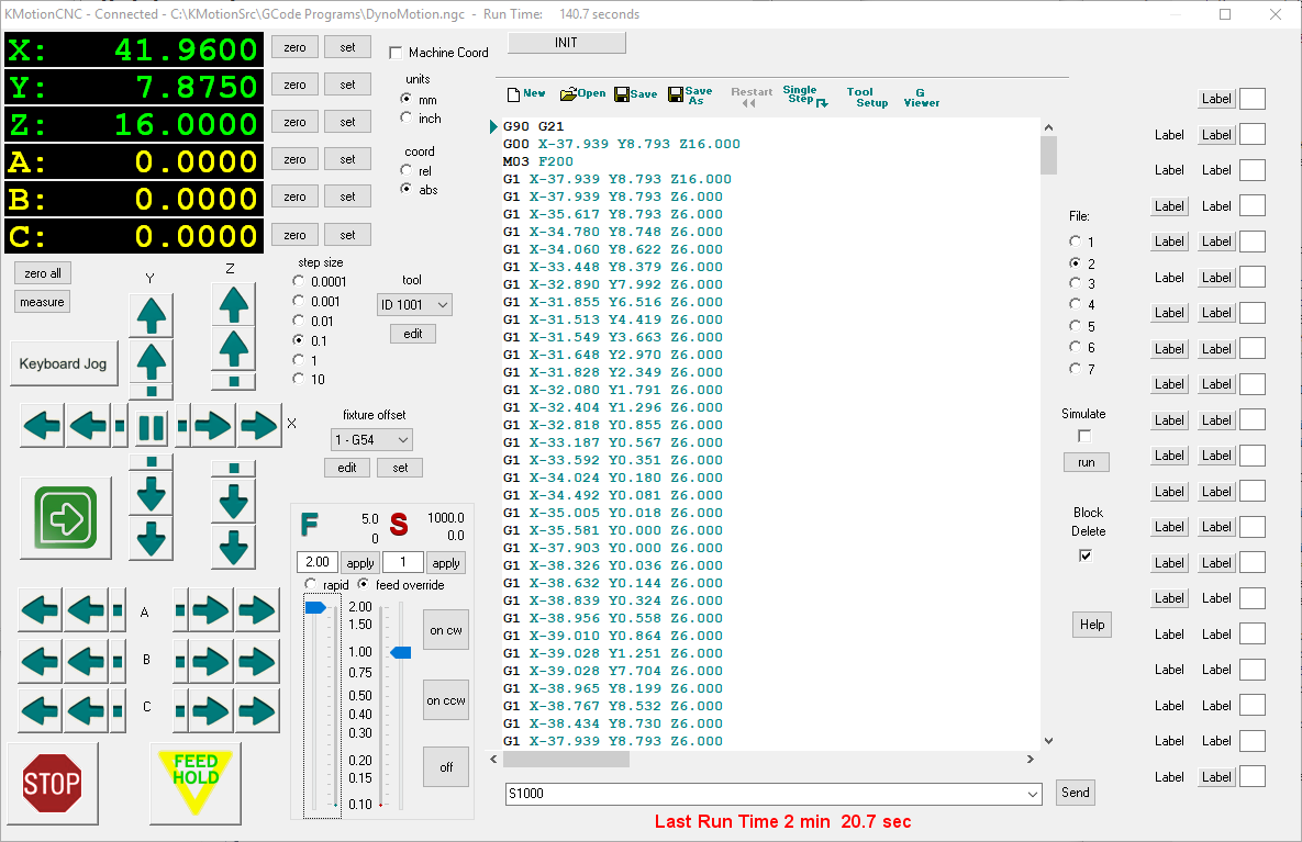

In Kmotion CNC there is a Run time option in Caption bar of Kmotion cnc here it is shown.
Screenshot (109).png (1.52 KiB) Viewed 6344 times
This run time i wan to print somewhere else using DRO Label on my KmotionCNC screen.
I want to know that how to use a DRO Label for printing Run Time.
Waiting for your kind reply.

Here is C Program that monitors whether a Job is Active, Time stamps when a Job Starts, detects when a Job Ends, Formats a Job Time message, and writes it to a DROLabel.

Attached is a Screen Script example (also Attached)with the DROLabel that looks like this:

Thanks for the reply.
The timer for printing runtime other then caption bar is working fine as expected by the program that you sent.
