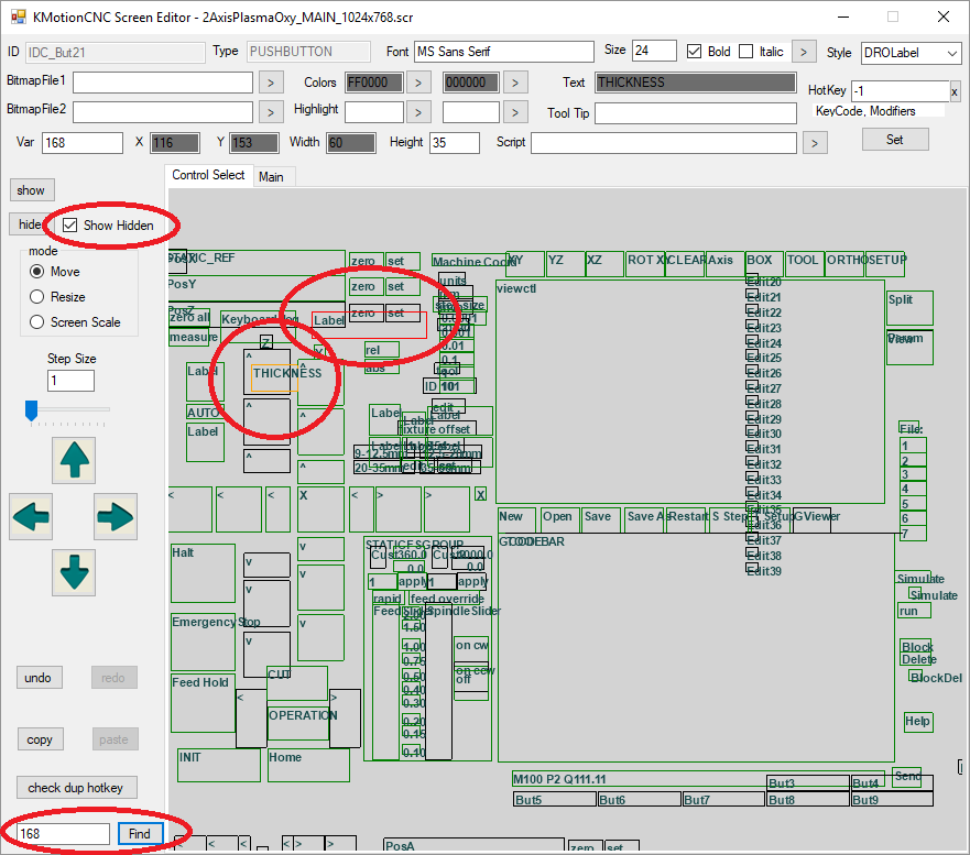

You have two DROLabels with the same Var=168. One hidden and one shown. On the Main Screen IDC_But21 and IDC_But28. On the Params Screen IDC_But13 and IDC_But28.
Here is a new Screen Editor with a build in Search/Find function to help with these mistakes. Copy to the \KMotion\Release folder.
The Find function will search all controls if the "Show Hidden" option is selected. It searches for partial matches of ID, Text, Fonts, Scripts, Bitmap Files or exact matches of Vars. See below:
Also the Text hasn't been set to $KEEP$
