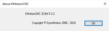

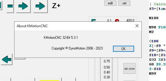

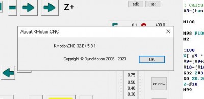

What Version are you using? Post Screen shot of About Box. (right click Title bar)
Re: no toolpath and tool shape is backwards
ok let me go look.....
i just deleted Kmotion on the office desktop
download the newest and YES it now works on that one
only .1 behind right?
is that enough to kill this?
