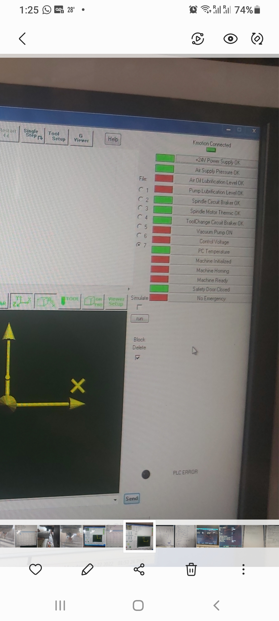

can we add more labels on the screen editor
I used all available labels to make leds indicators and descriptions
like now I have 12 leds on/of qnd description like control voltage on
can we add more labels to the screen editor? or not
thanks

No the screen editor doesn't allow adding controls.
There are 40 available User Labels. Have you used all those? Please post a screen shot of your screen.
Consider using multiple screens.

hello dear Tom
I used 435G
as shown in the attached screen. yes I used it all.
any suggestions dear.

I suppose you might have made all the labels with a single bitmap image.
But here is a patch for Version 4.35g for an additional 40 Labels. They are hidden and may be off screen so you may need to widen your screen and Show Hidden to see them.
Copy KMotionCNC.exe and KMotionCNCScreenEditor.exe to the C:\KMotion435g\KMotion\Release folder
Copy Resource.h and KMotionCNC.rc to the C:\KMotion435g\PC VC Examples\KMotionCNC folder
Please let us know of an issues.
