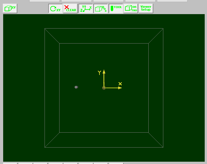

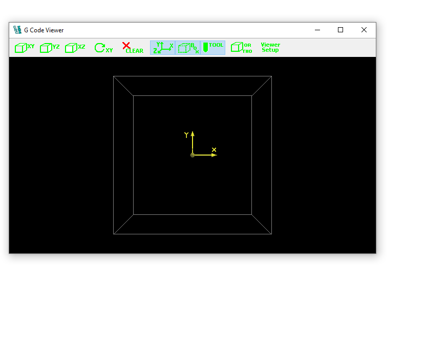

Hi Tom.
Can I somehow change the background color of the viewer?
I want to make it black instead of green.
Taras.
Taras.

Hi Taras,
Only if you edit the source code and recompile KMotionCNC.

No KMotionCNC is an Application Example that uses the Libraries. Open BuildExamples.sln. See Also.
You would change this:
in openglCTL.cpp
// Colors
m_ClearColorRed = 0.0f;
m_ClearColorGreen = 0.2f;
m_ClearColorBlue = 0.0f;
Re: Viewer color
Hi Tom.
Thank you Tom! I got it all.
