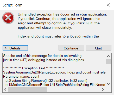

Hi, I was working on some custom screens using version 4.3.5f. All was going very well for several days. Then suddenly whenever I went to add a screen script to a button control the following “unhandled exception “message box would popup.
To try to see if I did something to one of my .scr files that caused this, I made a copy of one of the canned screen scrip files and added a button to it. Same exception happened. I next uninstalled and reinstalled 4.3.5f, no change. Then I tried this on a different PC that had 4.3.5f, same thing.
I’m wondering if there was a windows update that happened on both systems? Any thoughts on how to move forward will be greatly appreciated.
The forum will not let me paste the full detailed exception text, so I'm adding it as an attachment, as well as the image of the message box.
Screen Editor unhandled exception

Hi Larry,
We found a bug.
Please download and try this updated KMotionCNC Screen Editor.
Fixes crash when adding a Script command to a button where the Script is to load a Screen Script File and selecting a file in the same folder as the main Screen Script which is also in the default Screens directory. The code attempted to remove the path twice.

Re: Screen Editor unhandled exception
Thanks you for the amazingly quick patch! Just tried it and it works! You're the best!
