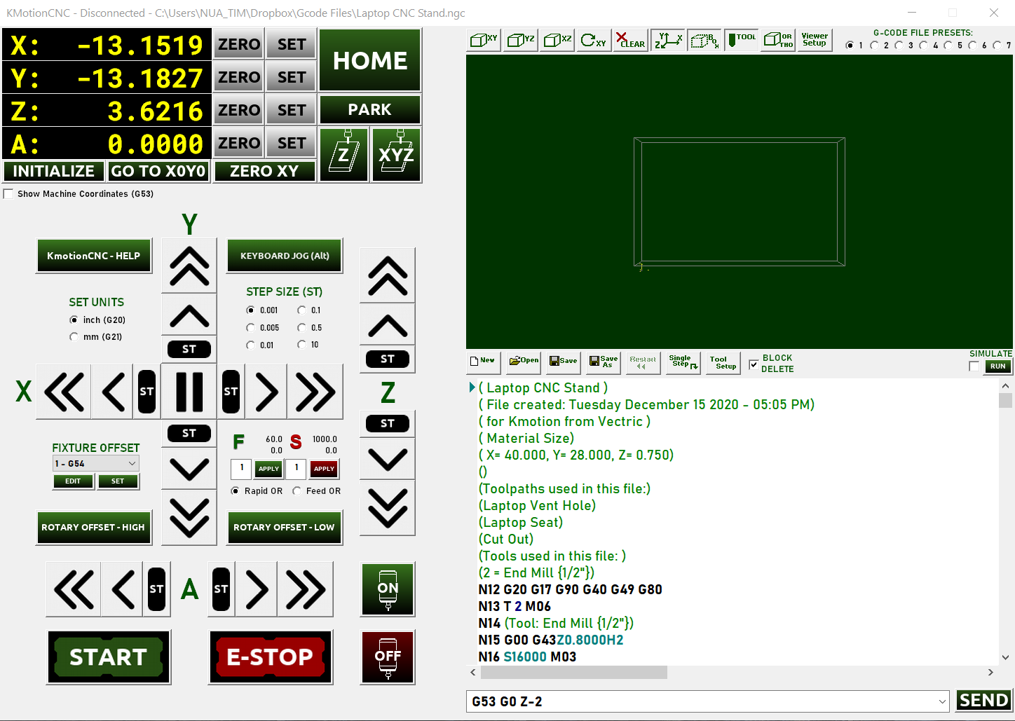

Sorry, this probably seems a bit type A and unimportant to worry about, but I've been making a custom UI for KmotionCNC with the Screen Editor and ran into an issue after changing the font on the axis DRO section. After the font change, the font wants to center a bit when the numbers are changing rather than staying fixed like before. For example, the "X" in the X axis DRO indents a tad and the coordinate number indents a tad from the right as well, centering itself in the box. I'd really prefer the X never move and that the decimals stay aligned like before the font change. I'm a bit committed to the font now because I've invested a ton of time creating custom button bitmaps using that font, so I'm hoping I can tweak this. Any ideas?

Will do, and here's the screen set after the font change. It was fun to get things dialed and styled to match my router setup.
Re: KmotionCNC DRO font alignment issue after font change
very nice screen set.
