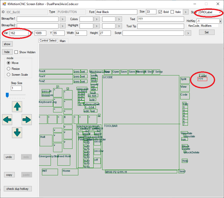

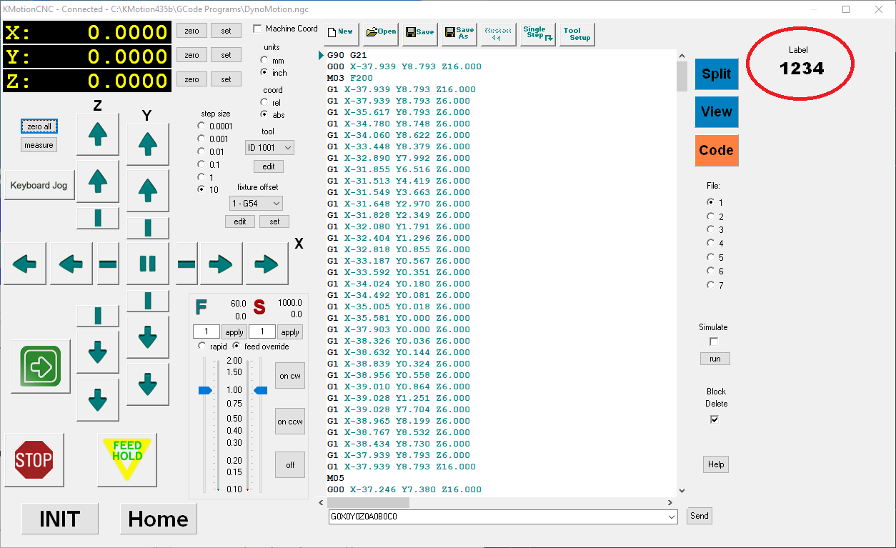

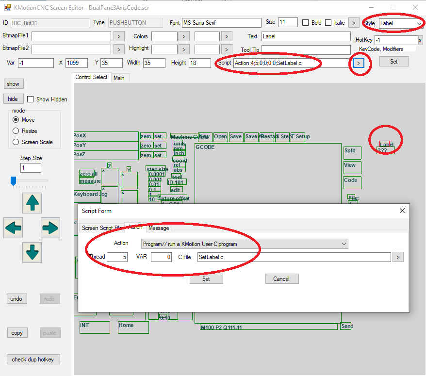

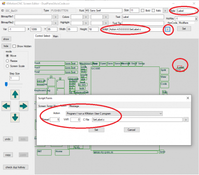

One method is that any simple Label Control that has a Screen Script associated with it will execute the Script whenever the Screen has been loaded.
So for example here is the example DualPane3AxisCode.scr with a new DROLabel and simple Label added. The DROLabel will be initialized (to 1234) whenever the Screen Loads:
The DROLabel is configured as shown here:
The Label with associated Screen Script is shown here. The Program SetLabel.c will be executed whenever the screen loads. Any existing Label or hidden Label may also be used:
A simple SetLabel.c program that puts 1234 into the DROLabel. Of course data could be anything from anywhere.
