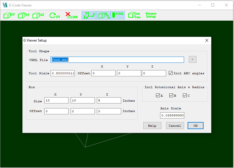

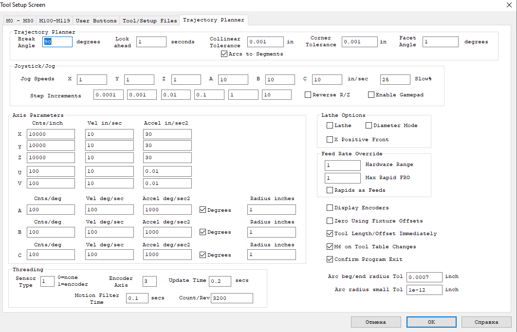

Post by TomKerekes » Fri Jul 28, 2023 4:14 pm
I think the Trajectory planner setting should specify 0 radius to operate as pure angle.
Also uncheck Include rotational axis with radius in the GViewer.
It would be helpful to know what you are seeing rather than just saying its a "mess"
