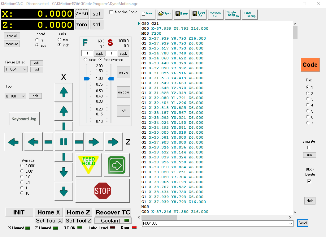

I've attached a screengrab of the current screen, which now shows all the main items I like to see. I've only done this, as I finally had some spare time to update the lathe to the latest version of KMotion, so used it as an opportunity to iron out a couple bugs in the C code, and make a screen with all the key info shown. I just need to remember how to access the Modbus values for the PLC inputs, so I can get the lube level indicator working now.
