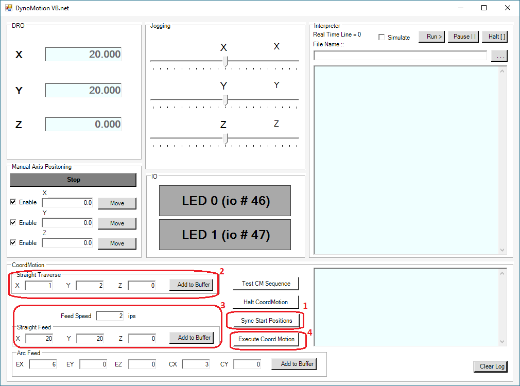

You might also see the Dynomotion VB.net Example which allows you to perform these steps through a GUI
