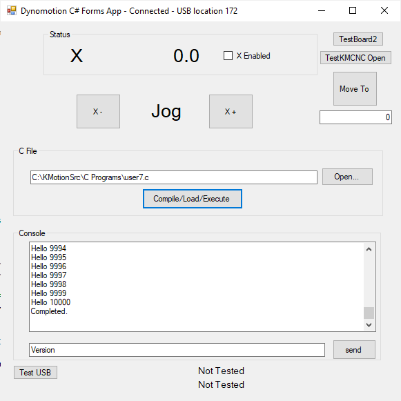

Hi Sam,
I just tested the C# .NET example SimpleFormsCS.exe from Version 4.35e and I don't see a problem. I ran it 3 times:
You might compare your method with the method used by SimpleFormsCS.

Based on what you tested, I did the same and had the same results. The SimpleFormsCS.exe app was able to display the entire loop of output from my c app without stopping short.

So I explored the SimpleFormsCS code a bit more. As an experiment, I removed all the mutex statements from SimpleFormsCS and the code still ran fine, returning everything from the KFlop C loop.
I then tried changing your ConsoleMessageHandler callback, emptying it of everything except a single line, adding
Console.Writeline(message);
....to determine if the problem was in the visual studio console as opposed to the textbox you were using to append message string.
Still no issue--the SimpleFormsCS code returns the entire loop to the console as promised.
