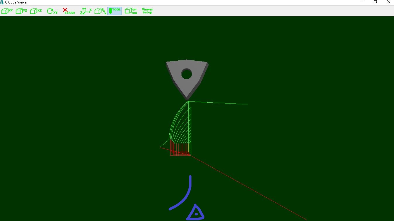

If you're using a custom screen the the plot goes to the Viewer on the main screen not the floating resizable screen. I suppose we could make that an option.

Here is a patched KMotionCNC.exe for Version 5.3.1 where if the Screen Editor is used to set the Main Screen GViewer Control's Var=0 then the GCode Path will be directed to the floating GViewer Dialog. Copy to the \KMotion\Release folder. You will need to reload the Screen File before the change becomes active.
Please let us know of any issues.

also i noticed my program is backwards. the blue is the correct arc and tool position.
i remember doing this years ago and for the life of me cant recall the settings for this
