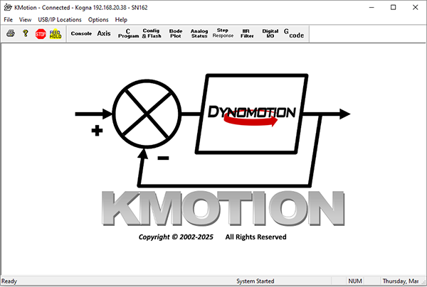

Run KMotion.exe from the Start Menu to check for proper automatic IP Address and Discovery of Kogna.
- To verify proper Ethernet connection to the Kogna board, use the Windows™ Start Button to launch the KMotion Application. After a few seconds the Title bar should indicate Connected and Kogna' s IP Address and Serial Number should appear. If KMotion doesn't connect see step 3 below.:

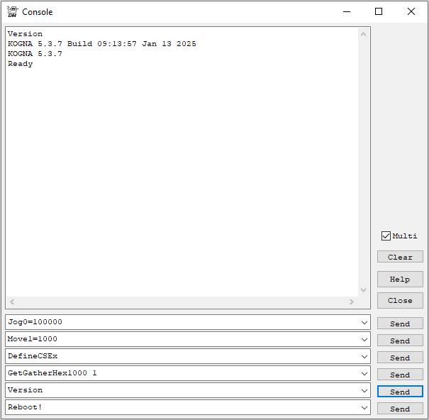

- At KMotion's main tool bar select the "Console" button to Display the Console Screen. Enter the "Version" command and press "Send". An output message will appear indicating successful communication between the PC and Kogna:

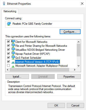

To set the PC IP Address in Windows 10 go to Control Panel | Network and Sharing | Change Adapter Settings | Right click - Ethernet | Properties | Select Internet Protocol Version 4 (TCP/IPv4):

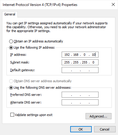

Select "Properties" then select "Use the following IP Address" and enter the IP Address:
Note the current PC IP Address can be displayed by entering the ipconfig command in a Windows Command Prompt.
